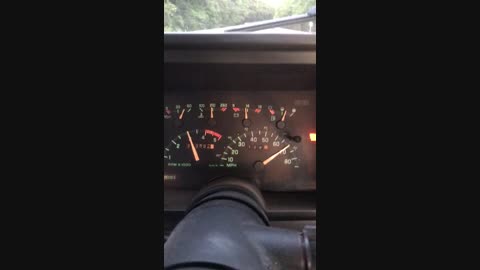

Yeah, I had the motor replaced. Here is the video the noise is the wind I had the window down. This was with my foot to the floor.
Jun 14, 2018 at 7:57 PM
SEAN SILBERHOLZ
  • 44 POSTS
It only would go to 3,000 rpm's and would not go any farther.

Thanks for the video. This looks like you have a plugged exhaust or catalytic converters. Here is a guide that will help you test the catalytic converters and see if the exhaust is causing the problem:
