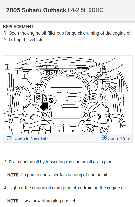

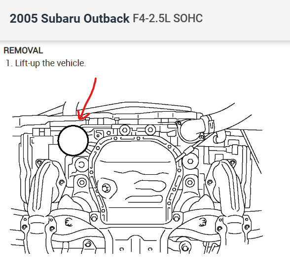

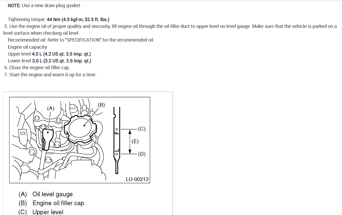

I would change the oil and filter ASAP. If the engine sounds okay, then no damage was done. Here is a guide to help walk you through the step with instructions for your car in the images below:
https://www.2carpros.com/articles/how-to-change-engine-oil-and-filter
Engine Oil
Grade .................... SL Energy Conserving II
Above -20° C (0° F) .................... 10W-30, 10W-40
Below 40° C (100° F) .................... 5W-30 (preferred)
Recommended grade and viscosity for severe driving conditions -
If the vehicle is used in desert areas, in areas with very high temperatures, or used for heavy-duty applications such as towing a trailer, use of oil with the following grade and viscosities is recommended.
API Classification SL or SJ
SAE Viscosity 30, 40, 10W-50, 20W-40, 20W-50
Capacities
Oil capacity .................... 4.0 L (4.2 US qt, 3.5 Imp qt)
Feb 4, 2025 at 9:51 AM
