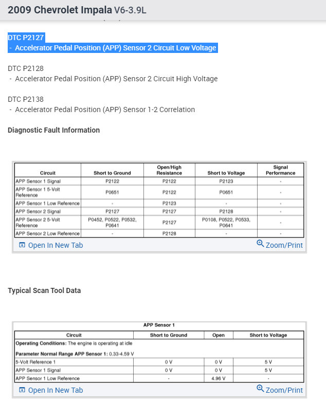

Received error code p2127 'Throttle/Pedal Position Sensor/Switch 'E' Circuit Low 'in my car about 3 months ago. Replaced the gas pedal. It fixed the problem for a few months but now it just came back again. Any ideas?
