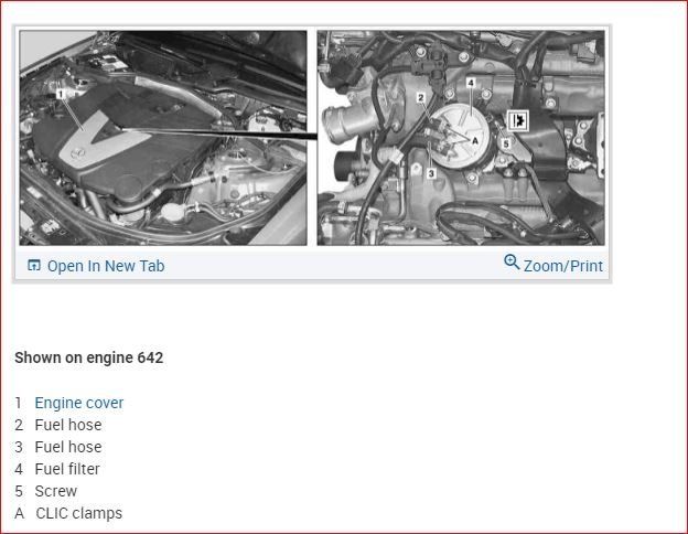

The next thing is if a diesel engine does not have the proper amount of fuel it will be down on power. If you have not changed the filter in a while, I would suggest doing that.

Hi. Thanks for your answer. Air filters has been changed two weeks ago. Also I thought myself about the fuel filter so I replaced it after this happened and didn’t make any difference. About the codes what can I do? how can I check it or where can I do it? Thanks
