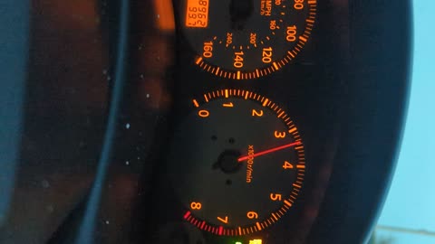

Quick video.
Apr 16, 2023 at 11:37 AM
Thanks for the video, it helps. It sounds like part of the catalytic converter has come apart and has clogged the muffler. I would raise the car up and use a mallet to bang on the exhaust to see if you can hear partials inside the exhaust system to confirm the failure. Please let us know what you find.

The squeal sounds like part of the converter?
The rattle noises were me going over train tracks. I'll get a better video today
