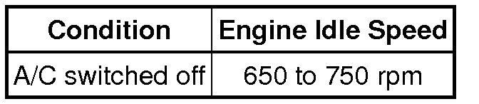

Standard (for Automatic Transaxle):
see pic 1

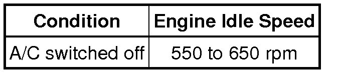

Standard (for Manual Transaxle):
see pic 2
