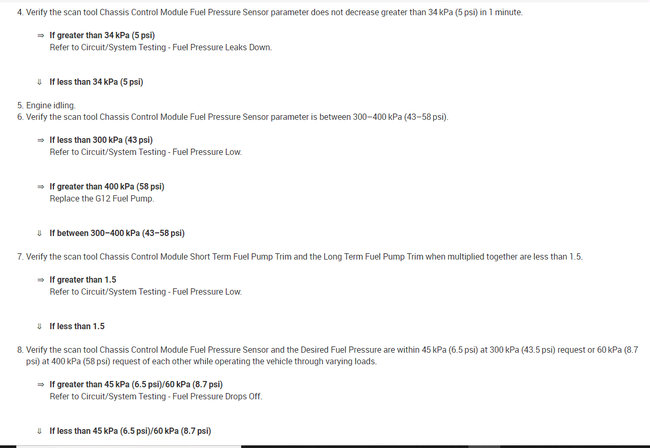

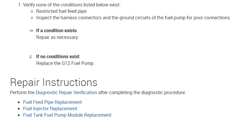

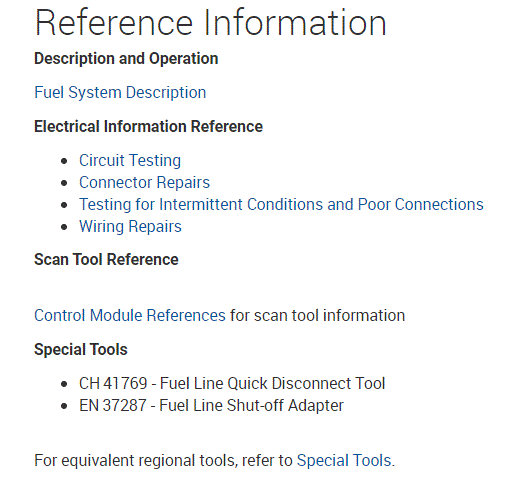

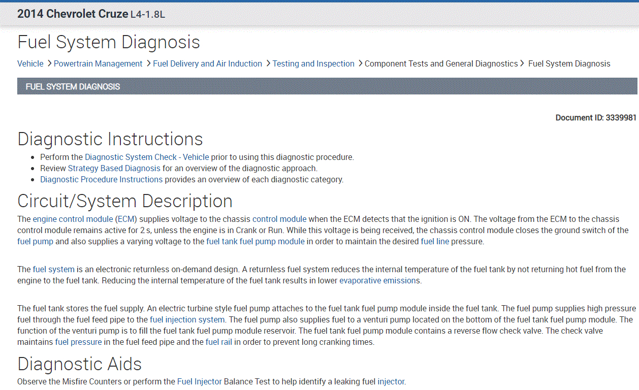

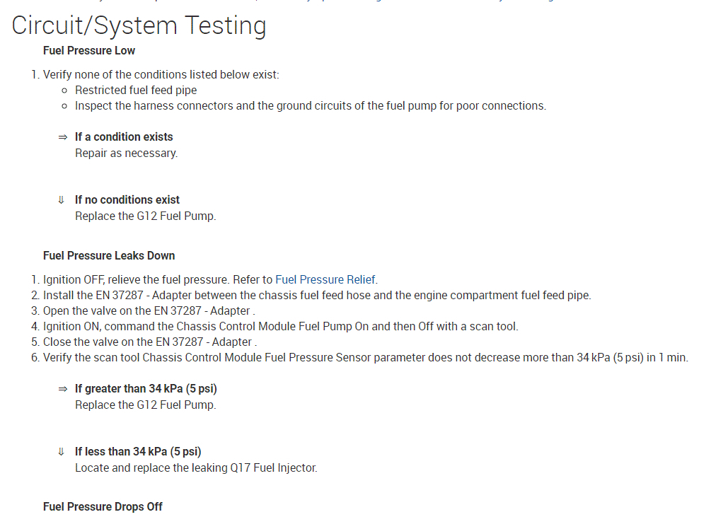

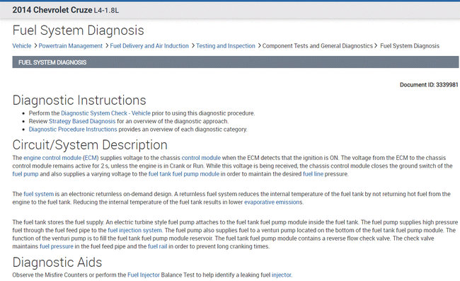

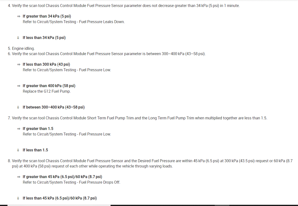

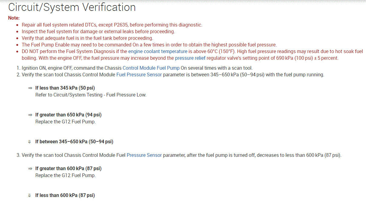

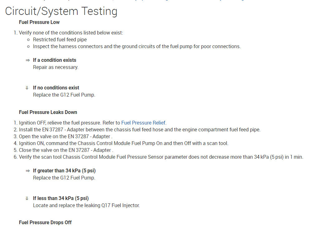

Also, if you haven't check fuel pressure, I recommend it. Here is a link that explains in general how it is done. Additionally, the attachments below are specific to this vehicle for fuel system diagnosis. Pressure may be too high due to a faulty regulator.
If you are questioning the catalytic converter, remove the upstream oxygen sensor to see if it changes how it runs. That will allow additional air to escape. Or, here is a link that shows how to check a catalytic converter:
See pics below.
