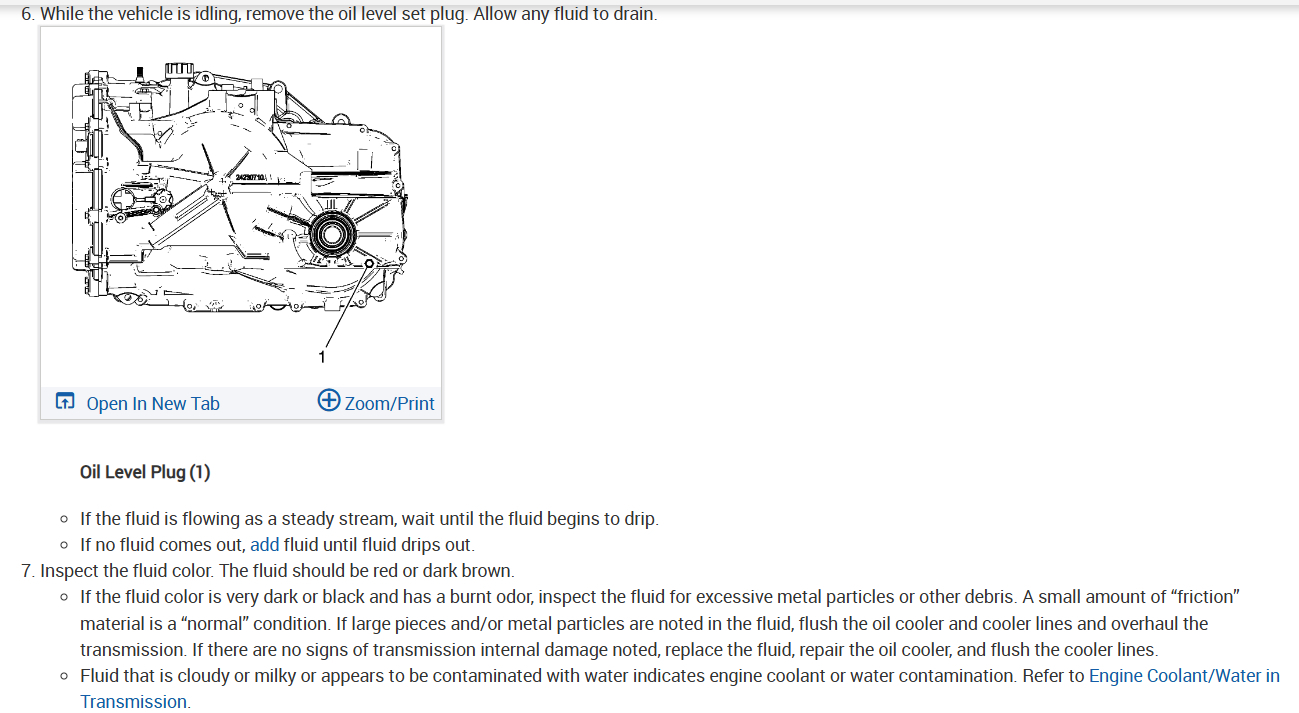

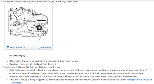

Here is a guide to help you with instructions for your car as well.
https://www.2carpros.com/articles/how-to-check-and-add-transmission-fluid
