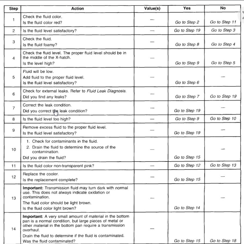

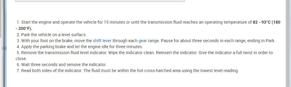

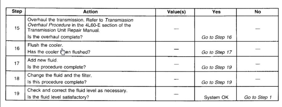

I attached below the process from the manual on how to inspect the fluid if you want to review that. Let us know what questions you have. Thanks
