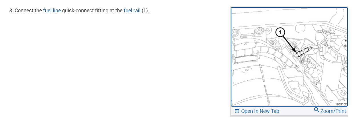

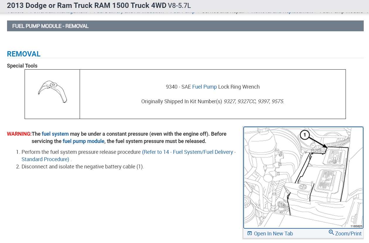

It sounds like you have low fuel pressure, but to be sure let's use this guide and you can rent a fuel pump pressure gauge from the auto parts store:
Fuel Pressure 58 psi +/- 2 PSI.

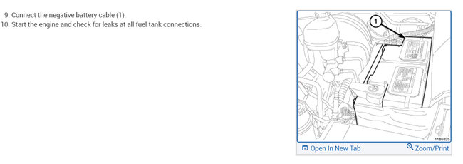

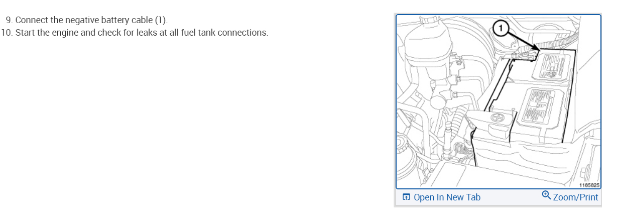

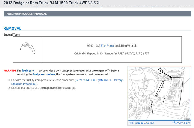

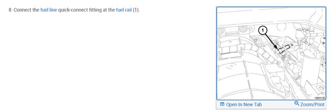

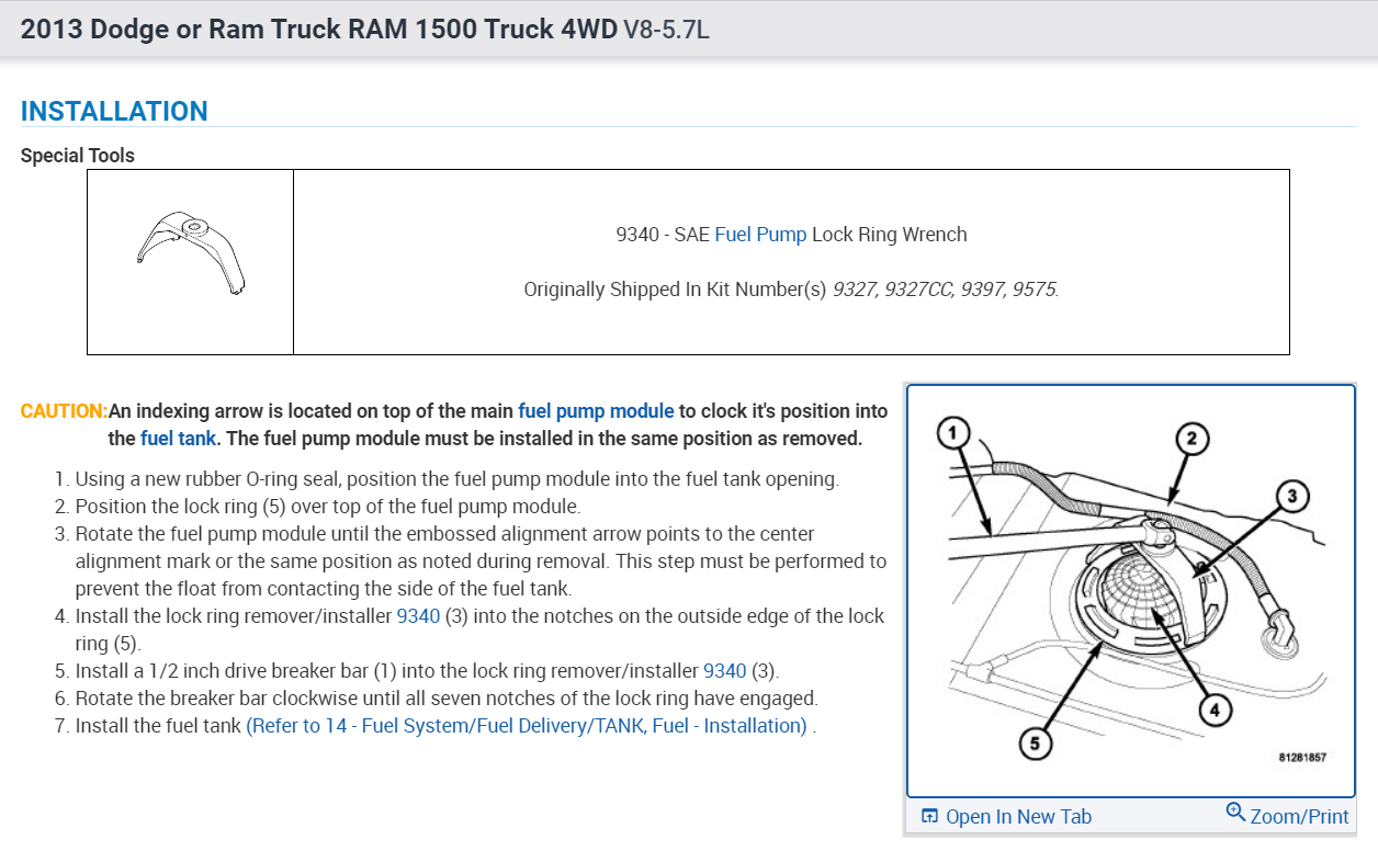

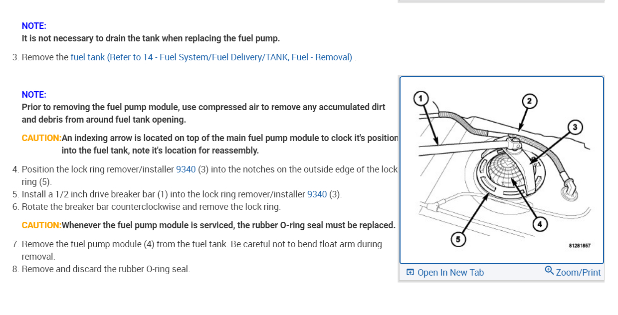

Here is how to change the fuel pump out. Check out the images (below). Please let us know how it goes.
