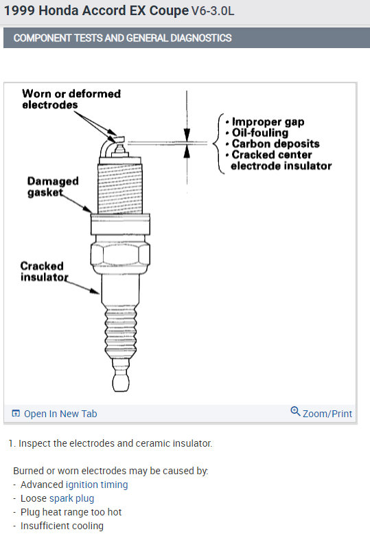

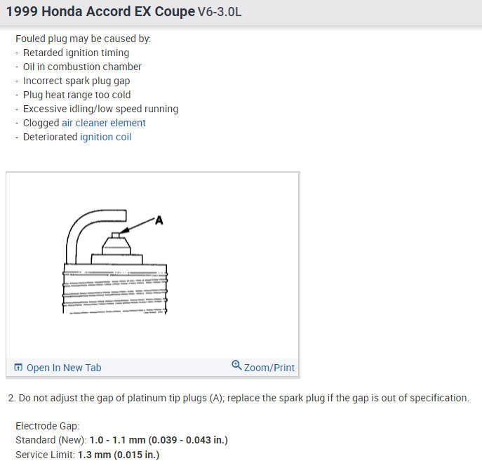

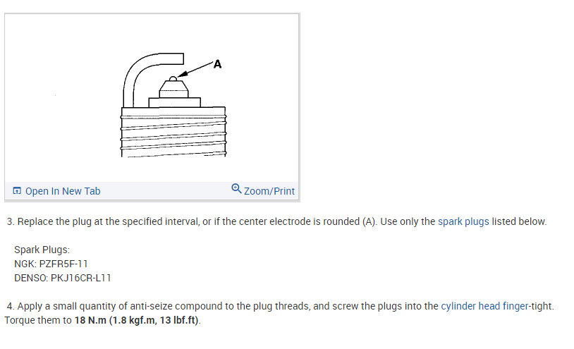

Does it feel like its misfiring?
Is your check engine light illuminated? Many times if there is an issue with a sensor or engine misfires the check engine light come on.
As the plugs gets old they can start misfiring under load (when accelerating or going up hill).
https://www.2carpros.com/articles/how-to-tune-up-a-car-engine
Please let me know little bit more info.
