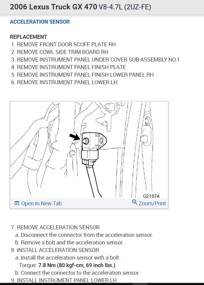

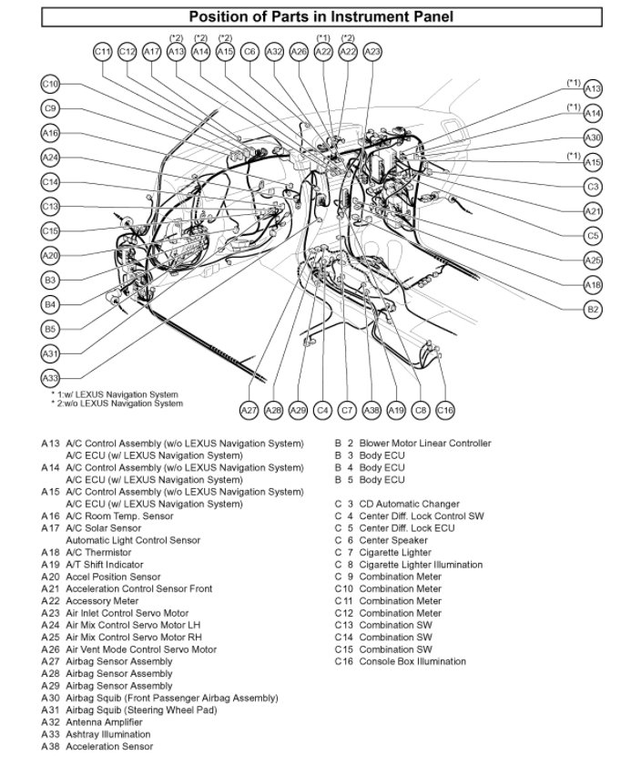

Check out the diagrams (Below) for the acceleration sensor. Please let us know if you need anything else to get the problem fixed.
