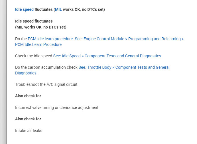

If this only happens when the engine is cold, then we need to check for a vacuum leak.
This is the most likely issue because when the engine warms up it starts to use the o2 sensor data and it can adjust for the additional air/lean condition so let's start with this guide and see if we can find a leak:
If there is no leak, then we are going to have to check for codes and then check the fuel pressure when this is acting up.
These guides will walk you through this but let's start with this info and go from there.

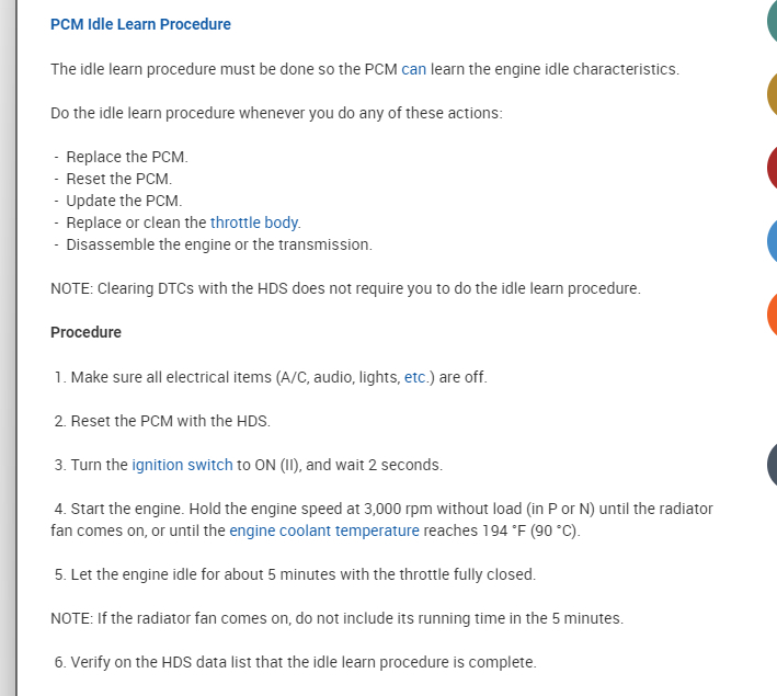

This could be a throttle body issue, but we need to check for vacuum leaks first as I stated in the first post. Here is a guide that will help with this:
However, I am also attaching more info on this issue. If you cleaned the throttle body, then you need to relearn the idle. Please see the attached information for this process.
May 10, 2022 at 12:39 PM

Hi, sorry buy what that mean HDS ?
May 12, 2022 at 12:35 PM
Sorry. The HDS is the scan tool that the dealer uses. You can reset the PCM using any scan tool that has that function. Basically, you need to wipe the memory in the PCM so that it forces it to relearn. You can do this by disconnecting the battery but that is also going to wipe out the emissions data and so you will have to drive it for a while to get these to run again. You will not be able to pass an emissions test until it relearns that data. If you don't have one in the near future, then you will be fine.
May 12, 2022 at 4:10 PM
