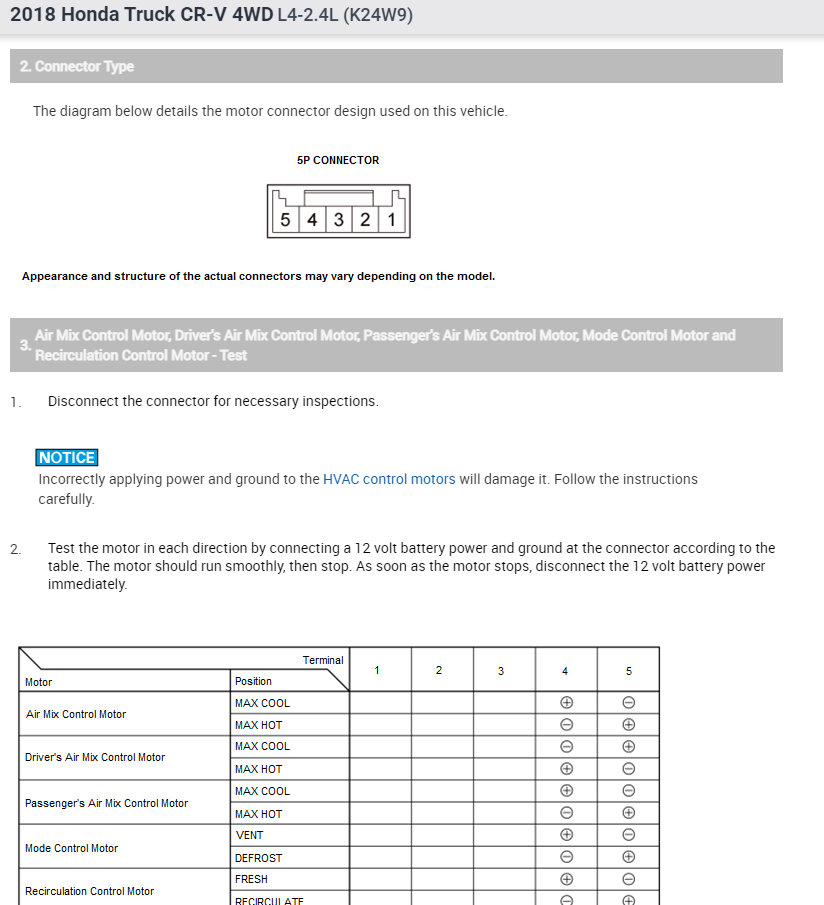

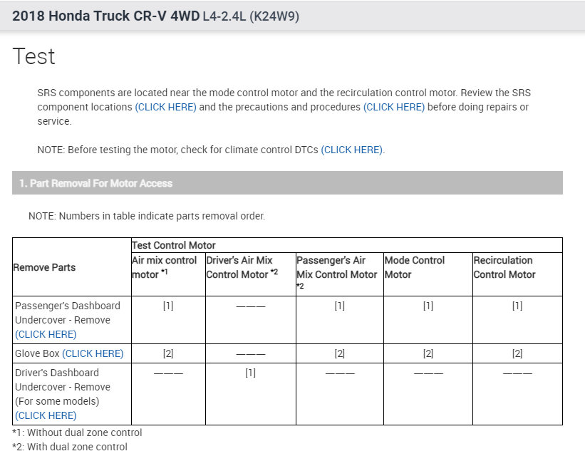

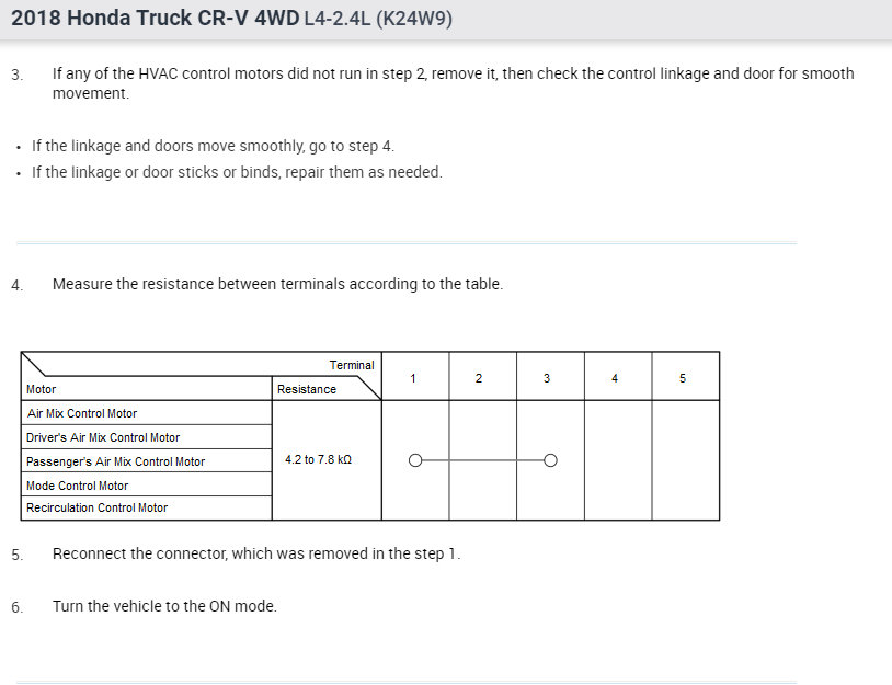

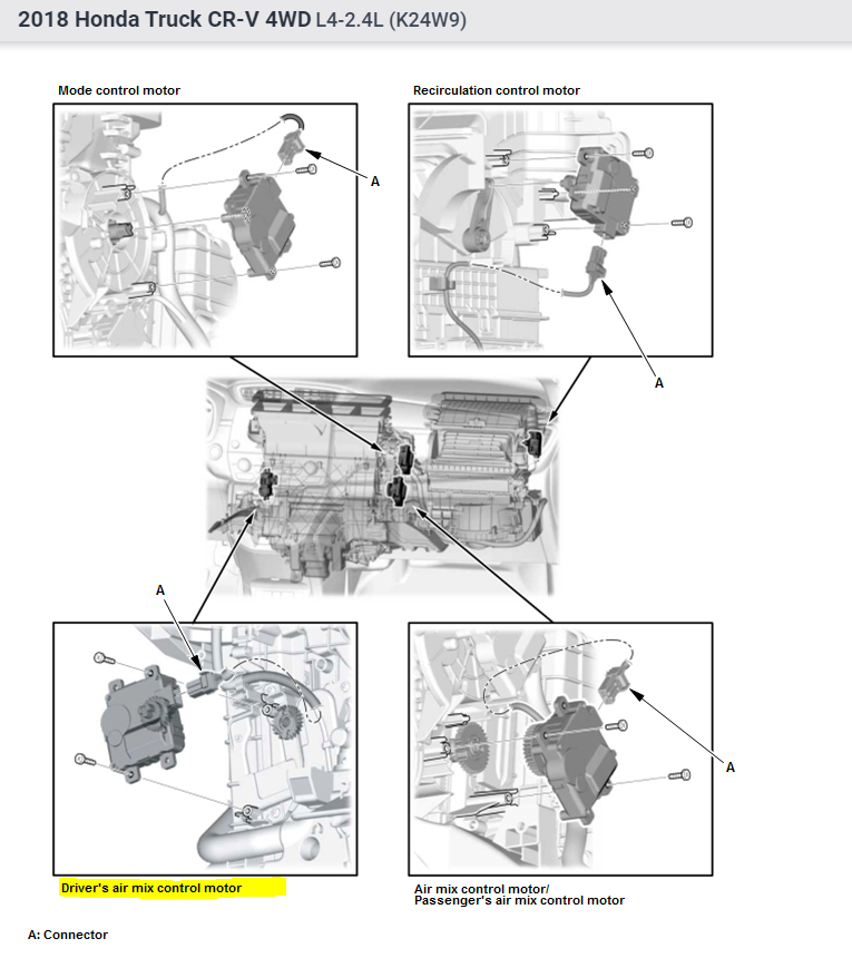

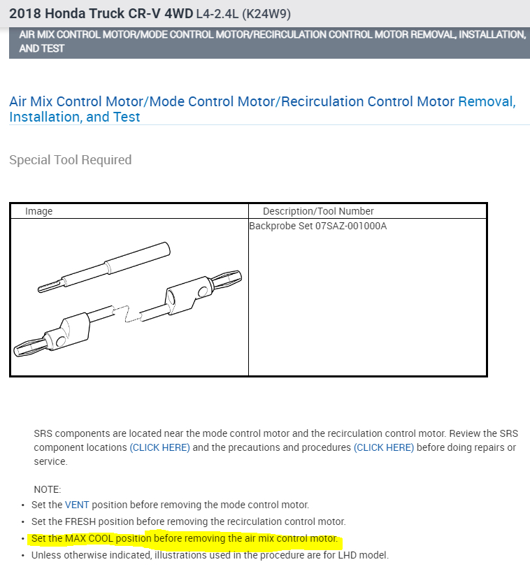

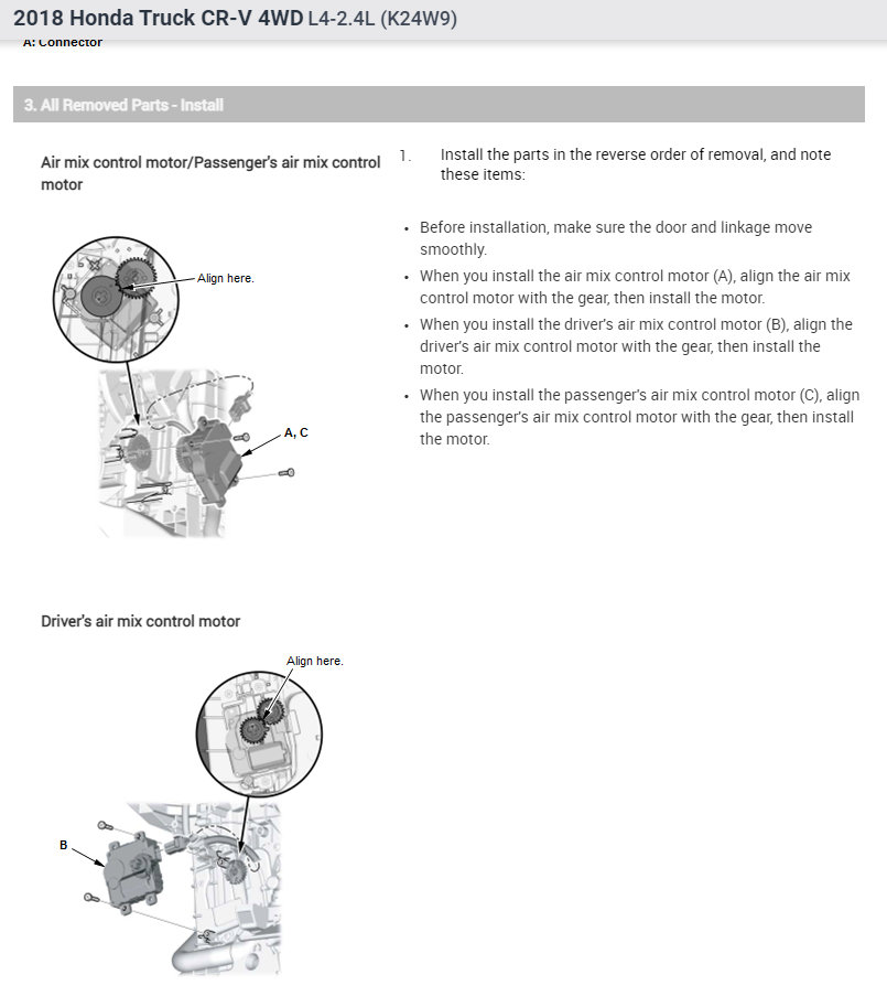

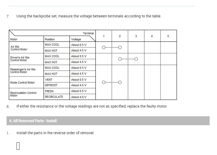

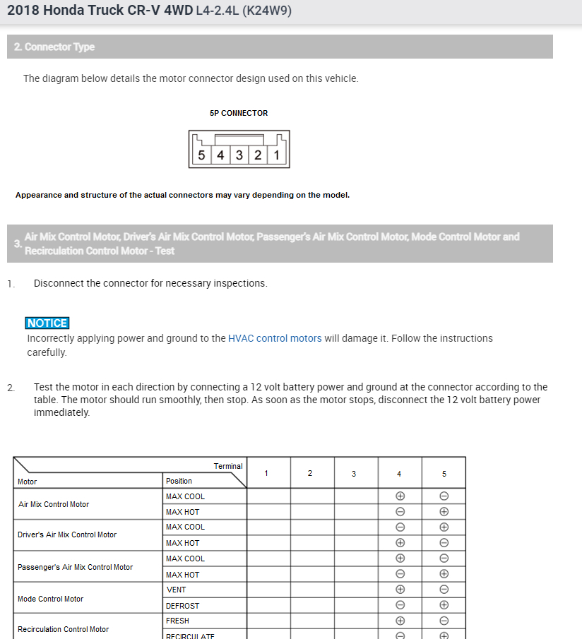

This could be due to a faulty blend door actuator for the driver side.
The blend door actuator/motor is what controls the flow or hot/cold air. It can fail in a position when it is stuck in a certain position and not allowing you to change the temperature.
The blend door actuator is located behind the dash on the HVAC unit.
I have attached diagrams below for your reference.
Let me know of any questions.
Thank you.
