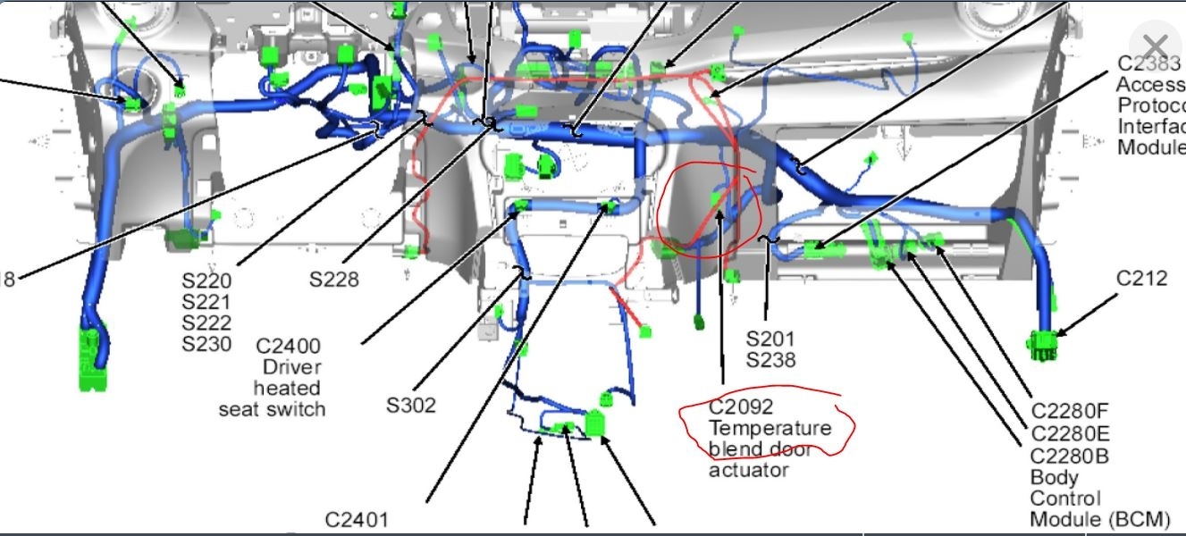

It could also be a blend door actuator but needs to be confirmed. I would check the Freon system first.
Temperature Blend Door Actuator
1. Remove the instrument panel. For additional information, (SEE Instrument Cluster / Carrier and/or Interior Molding /Trim).
2. Disconnect the temperature blend door actuator electrical connector.
3. Remove the 2 temperature blend door actuator screws.
4. Remove the temperature blend door actuator.
5. Note: When installing the temperature blend door actuator, be sure that the actuator gear, and the blend door gear are aligned so that the center (keyed) portion of each gear mates with the center (keyed) portion of the opposite gear as the gears are rotated.
To install, reverse the removal procedure.
