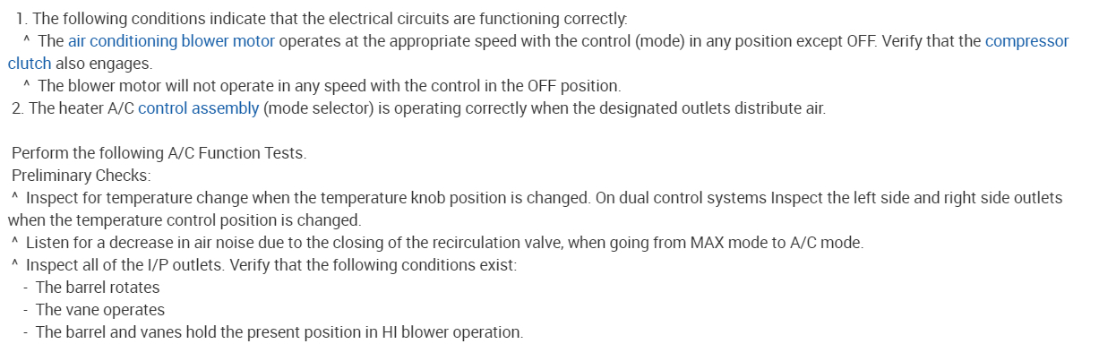

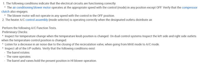

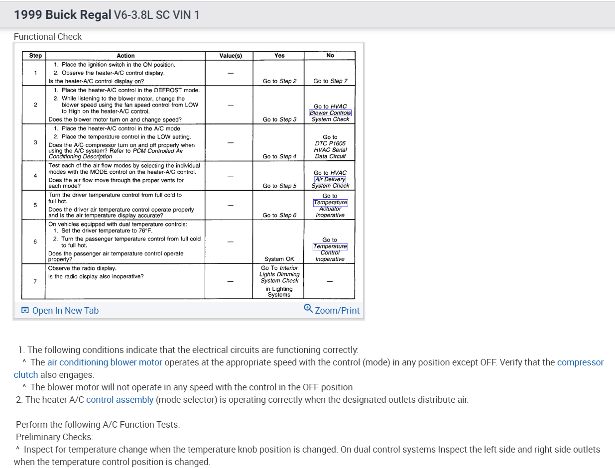

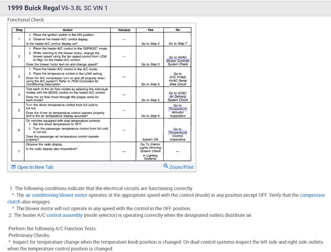

I would try to reset the system. here is how: it is more of a functional test, you may have a bad blend door actuator is the replacement a AC Delco? Check out the diagrams (below). Please let us know what happens.
