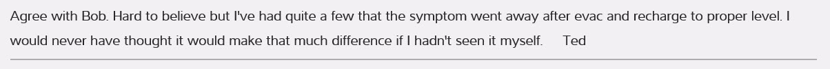

Try pulling hvac fuse inside car for sixty seconds with key on then reinstalling. It may reset it otherwise it will have to be checked. If this is automatic temperature control where you set the temperature it will need to be scanned for codes as it may be something else causing the problem. however since you said you just added Freon what i am sending in picture can be the real problem a lot of mechanics have had same problem and this would need to be done to fix it.

Well I tried Pulling the HVAC fuse when I got home from work it did not help. I saw the attachment you sent , failed to mention that I used a can of AC Pro to charge it up the passenger side is still ice cold.

yes, but it may be that what i sent is what needs to be done. this is what other mechanics have experienced with same vehicles.
