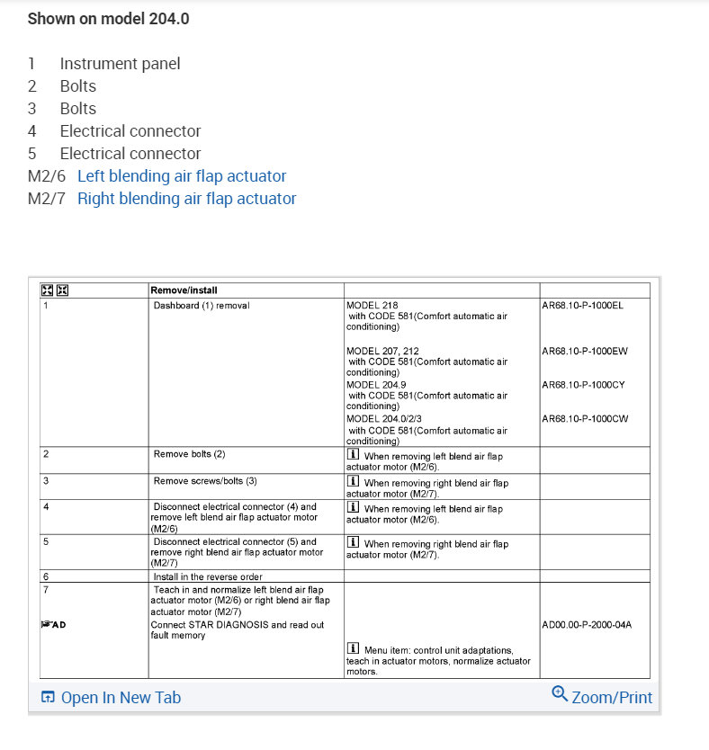

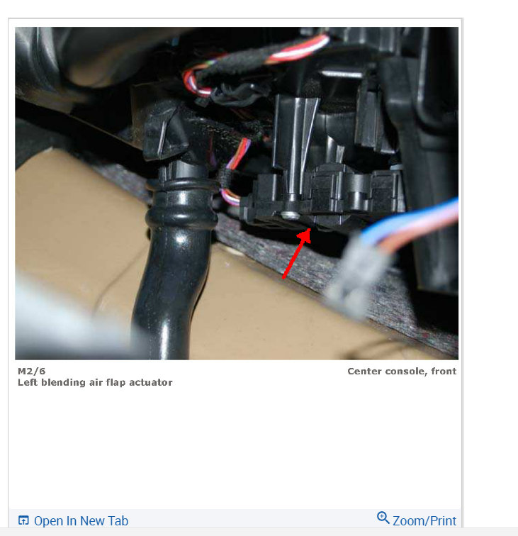

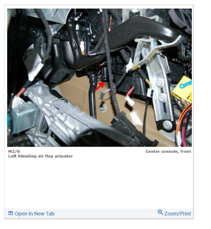

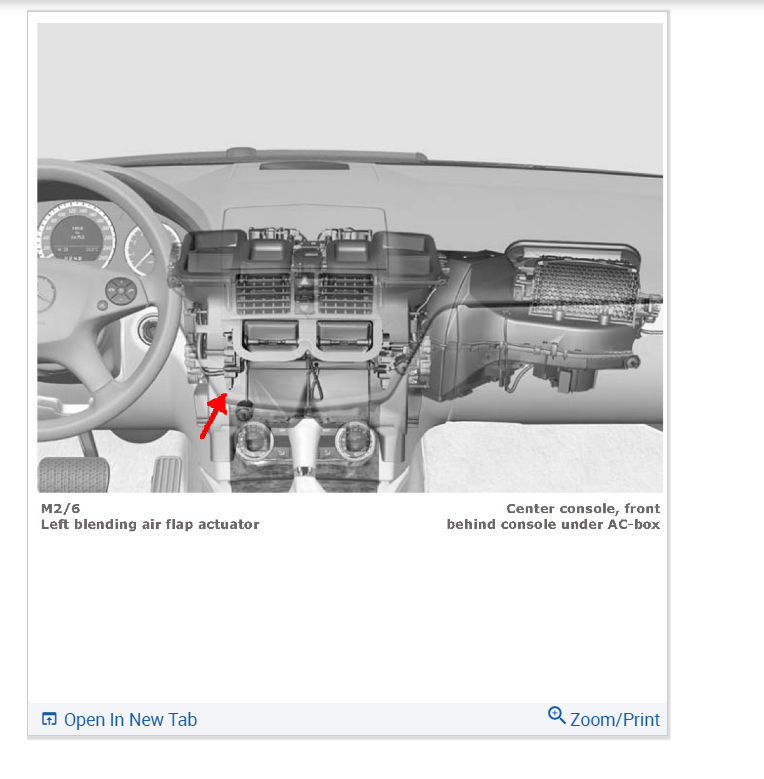

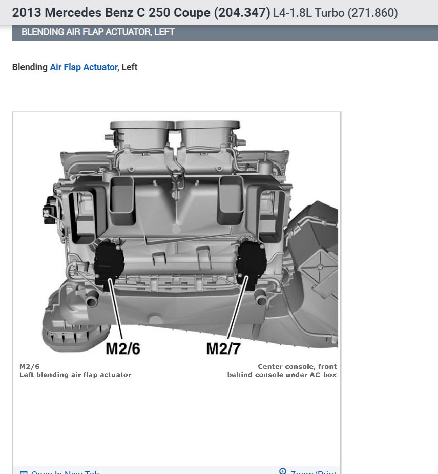

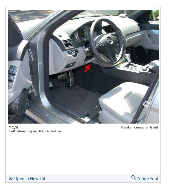

This happens when the rheostat inside the blend door actuator goes bad and is not allowing the controller to be stable. Here is the location of the part so you can check it out. There is no simple test for this, I would try a new part and see what happens. Check out the diagrams (below). Please let us know what you find.
Jul 12, 2022 at 9:08 AM

Does the panel around the carpet need to be removed? I cannot tell from the pictures.
Jul 13, 2022 at 11:41 AM
