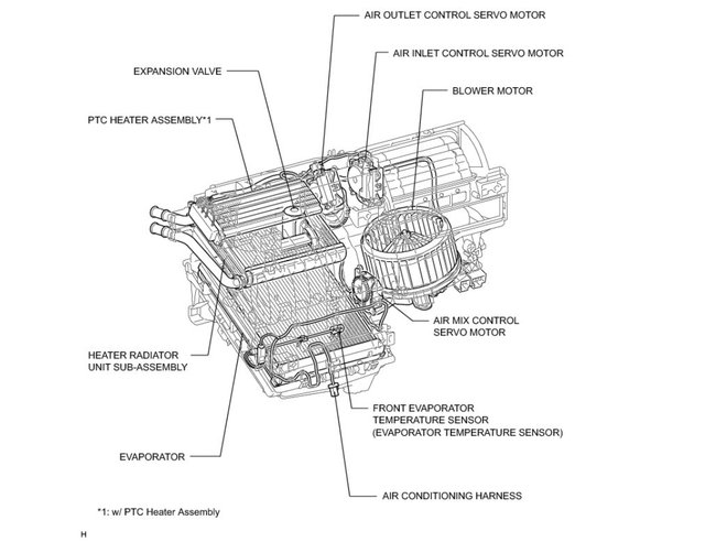

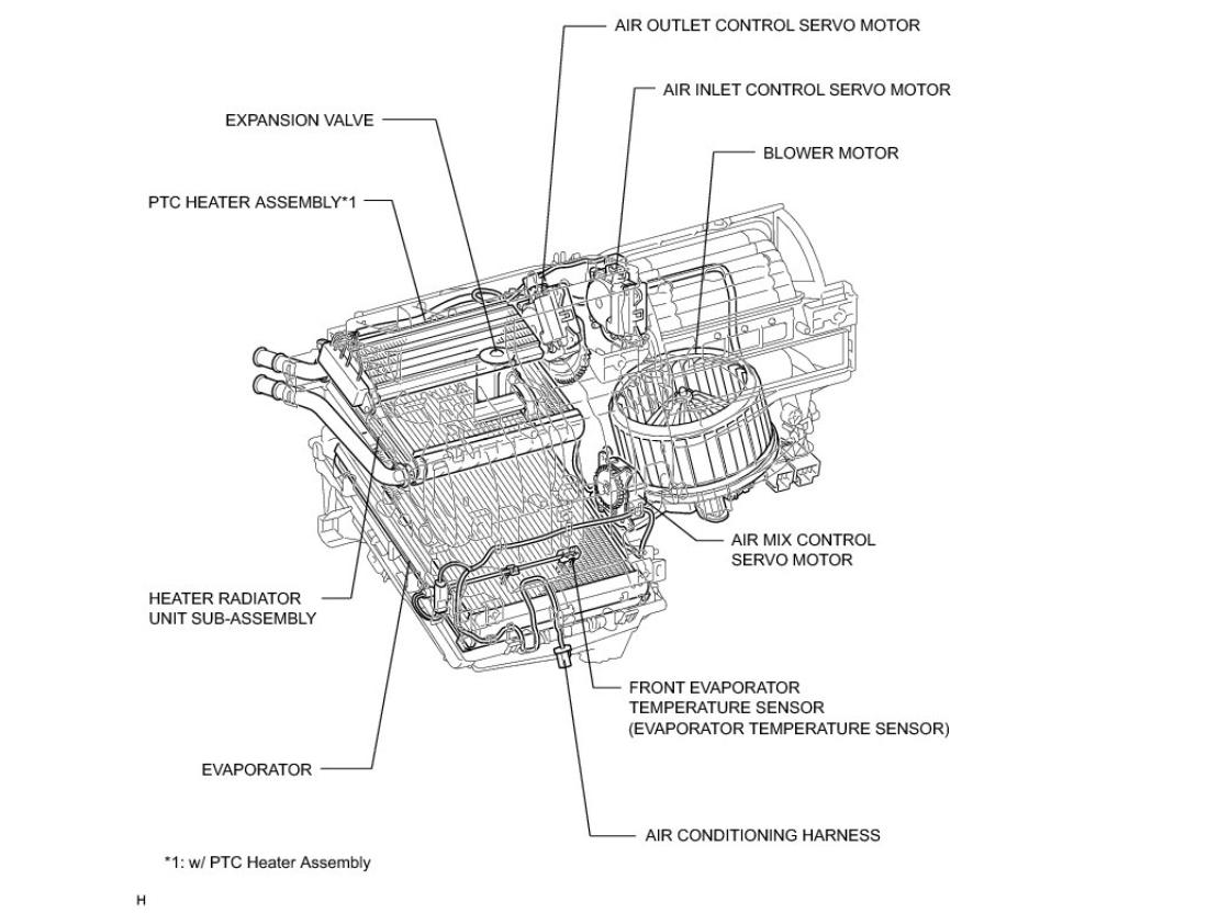

It sounds like the mode blend door actuator (air outlet control servo) is out and needs to be replaced. here is a guide to walk you throughout the repair steps with diagrams and instructions below to show you how on your car:
