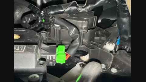

The BCM isn't causing this to happen. Interestingly, the blend air door actuator is responsible for the air temperature entering the vehicle. In this case, air flow changing direction, it sounds like the mode door actuator is failing.
I attached a picture of the mode door actuator. What we need to do is determine if that is where the clicking is coming from. Usually, the small plastic gear in the actuators strip and you hear the noise, and the component fails to operate properly.
See pic below.

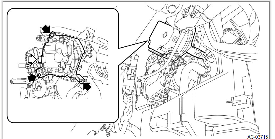

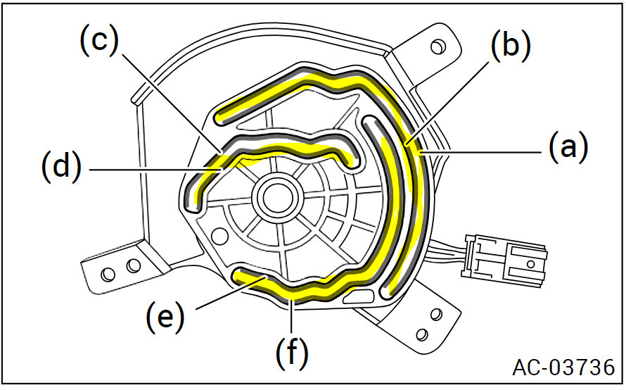

I can only think that some grease may have been needed on the rail plate. It could be hanging up a bit if you didn't do this. Although I do this, it isn't always required.
I attached a pic below and highlighted the areas I'm referring to.
See pic below.

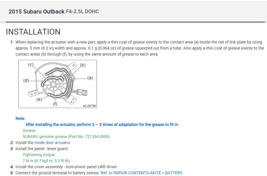

The positioning shouldn't matter. I attached the installation directions below for you to review. There is nothing indicated for alignment or relearn. However, they do stress the grease. Actually, it indicates adding the grease and operating the actuator several times prior to installation to evenly spread the grease.
Take a look.
See pic below.
