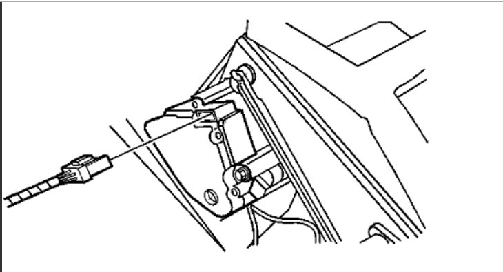

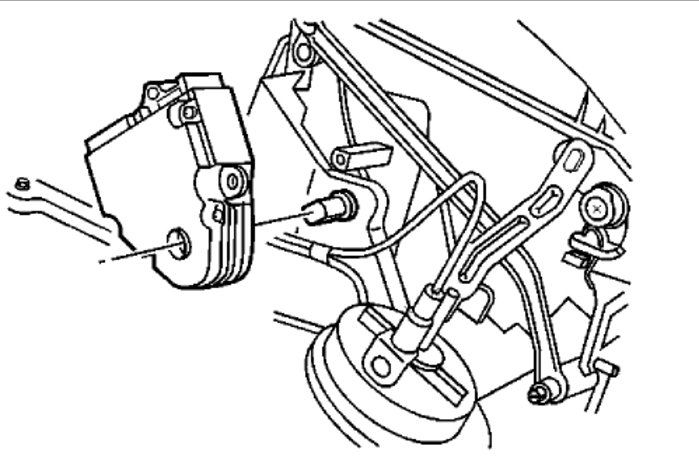

You have a blend door actuator that has gone bad. Here is a guide to help you get the problem fixed:
Here are some diagrams (below) that will show you on your car.
