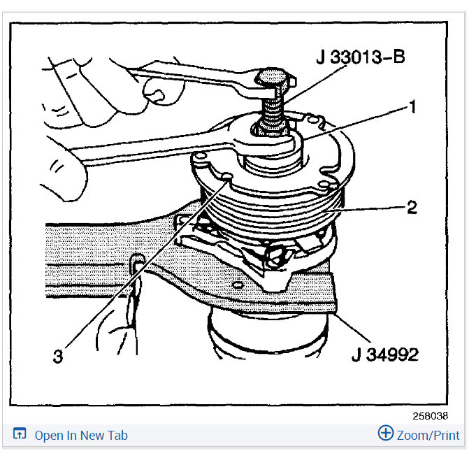

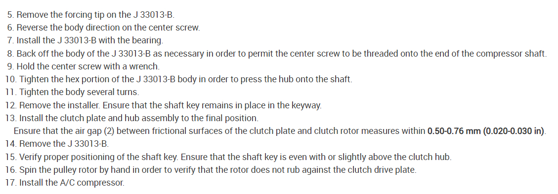

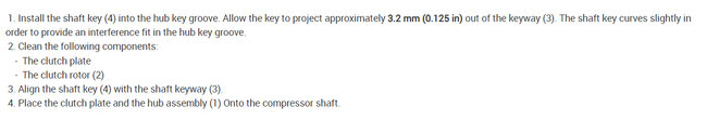

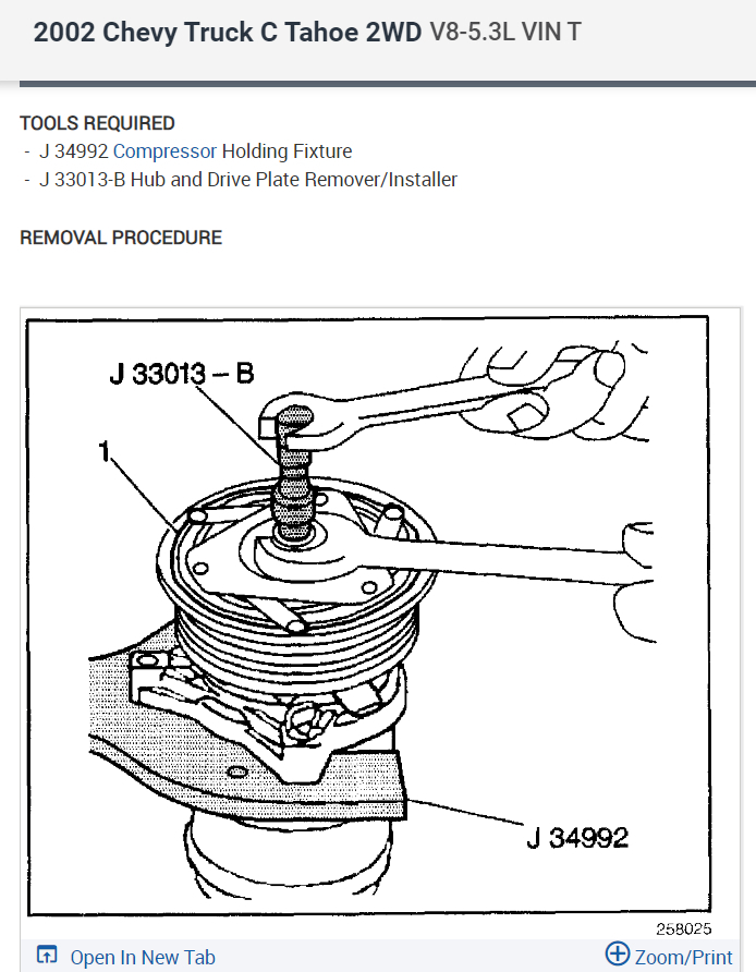

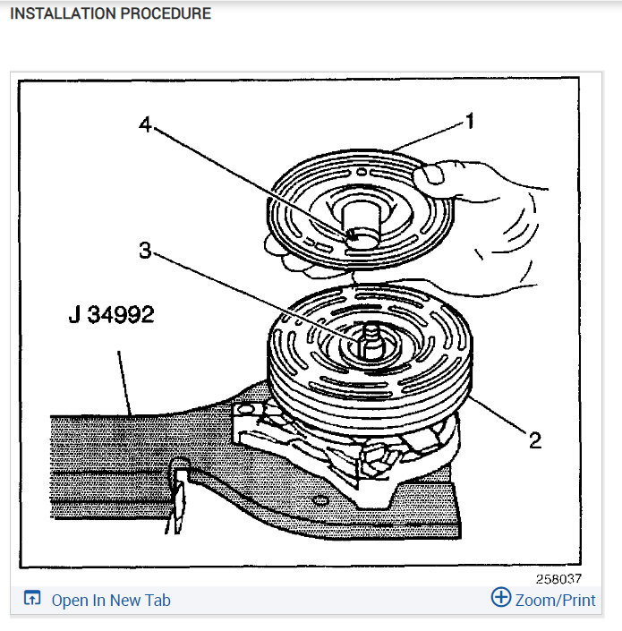

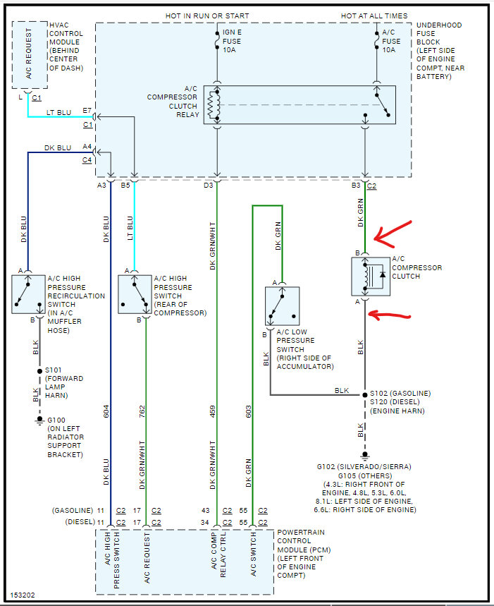

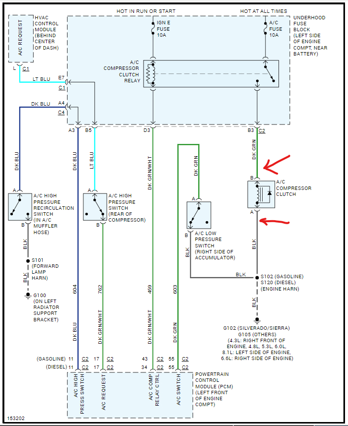

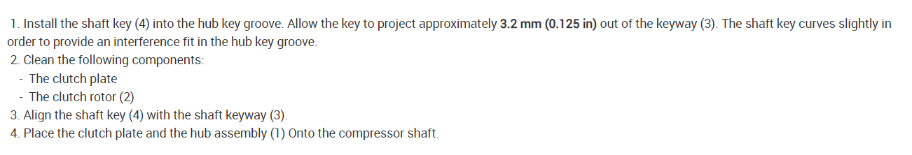

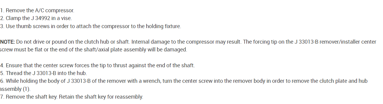

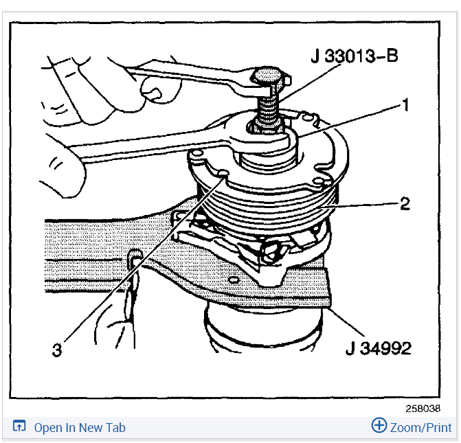

Thank you for your comments :) we try to do our best. Here is how to change out the compressor clutch and coil to help fix the problem, but to be sure the clutch is getting power with the system on with a good ground correct? This guide can help:
Check out the images (below). Let us know what you find.
