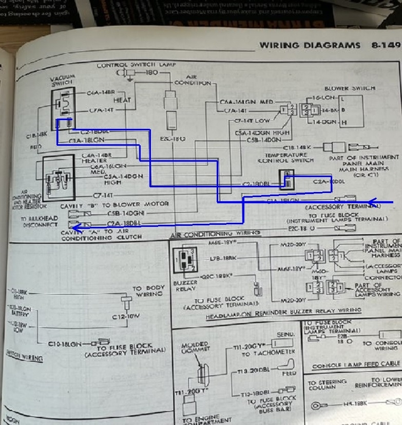

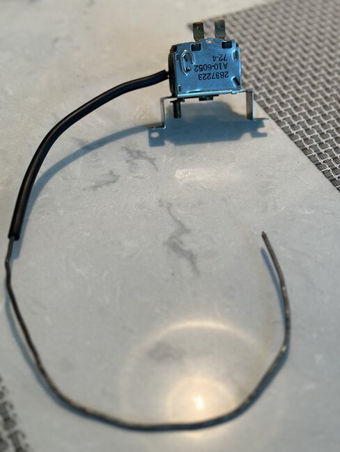

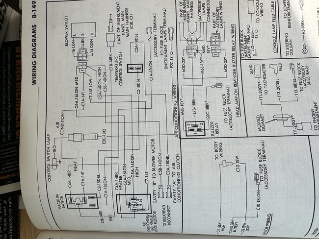

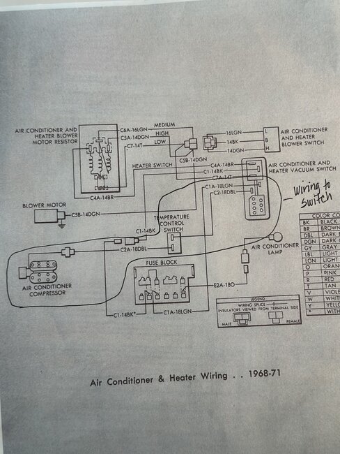

This is helpful for the switch that is in the vehicle, however the switch I am testing is currently out of the vehicle. I have included pics of the switch and diagram.

Thank you for posting the diagram, but be aware there were a lot of changes between the '71 and '72 models. My '72 Dart had a relay running the compressor coil. I don't see that in this diagram.
The switch you posted is indeed a cycling switch. The compressor clutch coil could draw a good five amps or more. That's a lot to ask of a set of switch contacts to handle. Regardless, you can jump those two wires together with a fairly heavy jumper wire to make the compressor run. Let me know. If you don't get to it soon, I'll be back tomorrow evening to see how you're doing.

Yes, thank you, I have bypassed the switch on the vehicle. The diagram I sent you is out of 1968-71 but, it is wired the same as a 1972 (included, out of a 1972 FSM) my Scamp has no such relay. I felt the original I sent was easier to understand. My concern was that both the switch that is in the vehicle and the one that I am testing outside the vehicle tested the same way. I don’t want to invest in the cost of another switch if either of the two switches I have are working and that is what my concern was, they both tested the same.

Even if I'm interpreting that switch wrong, if you start at the lower left where it says, "Cavity "A" to air conditioning clutch", then work your way back to the "Temperature control switch", you know you gotta have continuity through that switch for current to flow to the clutch coil. Given the nifty photo you posted of your switch, and the way it's labeled here, it is the control unit that regulates system operation. It's not a safety cutout or anything like that. You can safely bypass it temporarily with a jumper wire, but that wire should be fat enough to handle at least five amps. A 14 gauge wire can do that.
You originally mentioned you found 12 volts on one side of that switch, but not the other side. Logic would dictate the switch is open, but check that again with everything connected. Now, if you find you have close to 0 volts on both wires, the high resistance is in the vacuum switch, or, less likely, the wire running back to it. What you would do is keep working your way back to the various test points until you find where you still have 12 volts, and the one next to it where it's missing. I know I'm not explaining that well, so I'll do a better job of it later if it comes to that.
Another fun fact to share with your friends and family is while the AC system was factory-installed, it looks like an aftermarket add-on system by the way it hangs down under the dash. What reminded me of that is when following the diagram back to the power source at the right side of the diagram, it is not coming from a fuse dedicated for the "AC" or "Heater" system. They're using an Accessory terminal in the fuse box. That terminal was often provided for owners who wanted to add a CB radio, tape player, or things like that, and they didn't want you to compromise the tension on the fuse holder terminals by stretching them with an extra wire stuffed in there. It also relieved them of some liability issues if something in the fuse box started a fire. For dealer-installed options, the cruise control would be a better example. Everything came in one package, including the wire harness to connect all the pieces, then the last step was to plug the 12-volt wire into that "Accessory" terminal. You didn't have to rewire the fuse box.
So, to boil down all this great and wondrous information, jump the two terminals on the "Temperature Control Switch", and the compressor should run, but the engine will have to be running so the intake vacuum turns on that vacuum switch. If that works, the next issue is finding a good replacement. I didn't see one listed on Rock Auto. AC in those early years was pretty rare, so finding a used switch in a salvage yard will be hard. I'm in Wisconsin where anything over ten years old is rusted away due to the unnecessary overuse of salt in winter. You'll have better luck down south.
