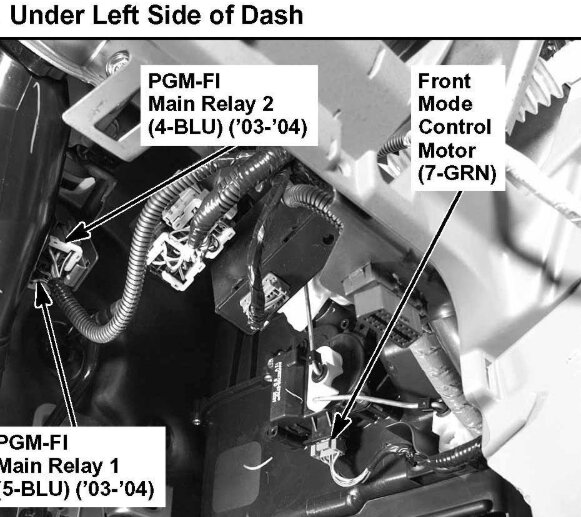

Yep, it sounds like the mode actuator is not working correctly. Here is the location of the actuator so you can swap it out, no video that I know of on youtube sorry, check out the images (below). Let us know how it goes, Ken
