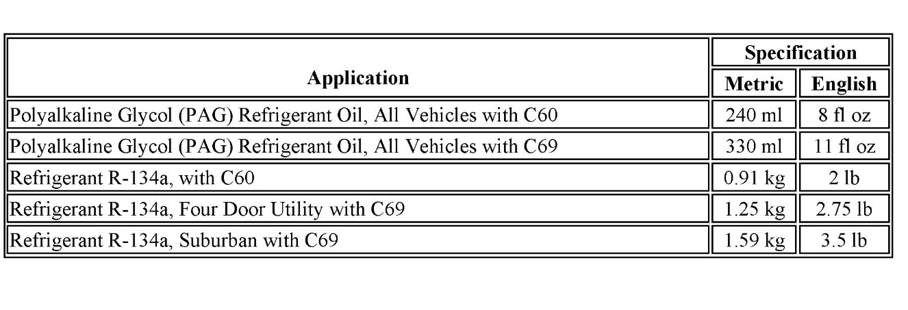

The refrigerant amount is on the chart I attached,

Looking at your chart 3 12 oz cans of 134a did not come close to filling the system. Although pressure on high side did show 120 psi.
