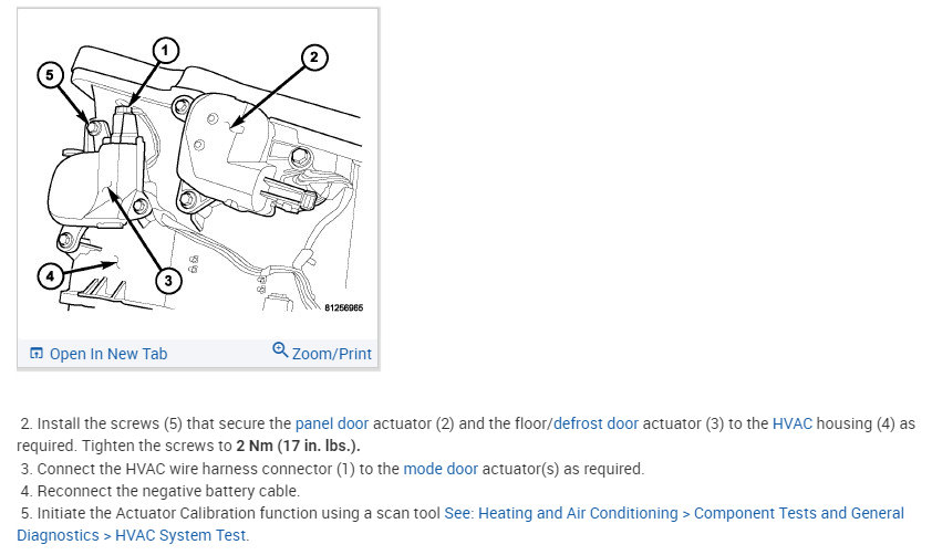

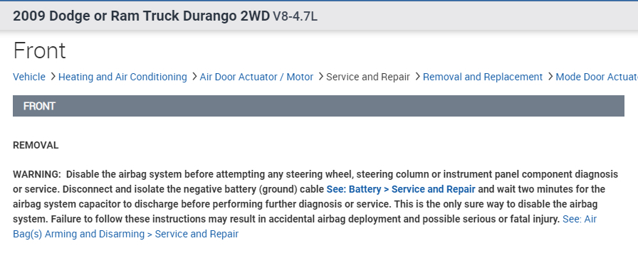

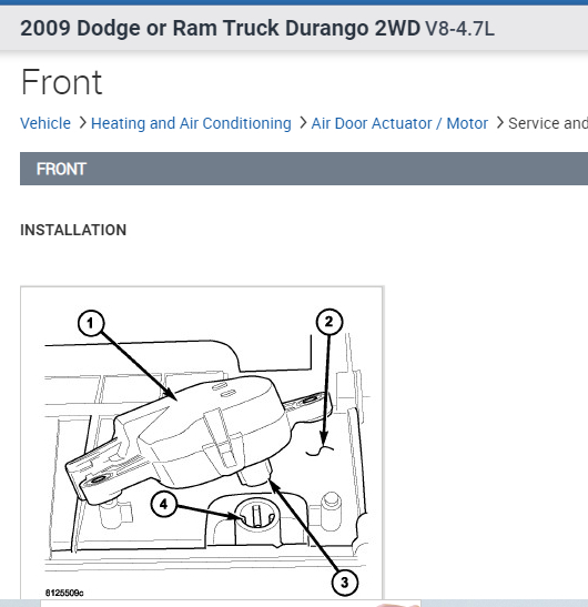

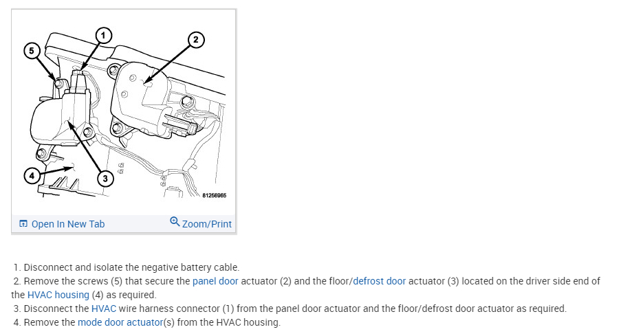

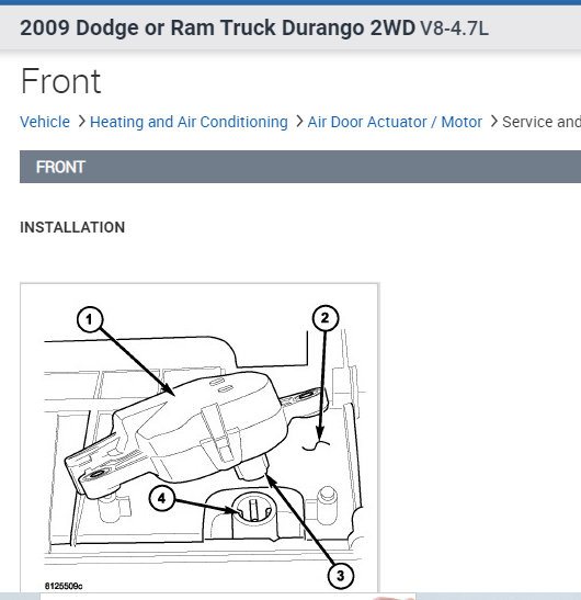

I attached the directions for replacing the actuator below. They are mounted on the HVAC box under the dash. Make sure the battery is disconnected for at least 30 minutes before working on it. Also, before replacing anything, pay attention to see if the airflow direction is changing. Also, with them removed, pay attention to see if you hear a clicking sound when this happens.
See pics below.
