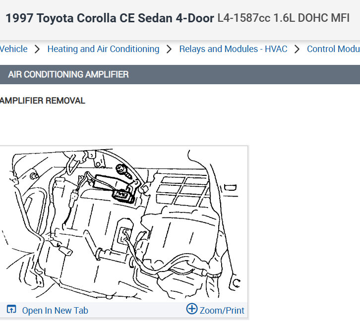

Yep, these cars had a problem with the AC amplifier which runs the system, here is the location so you can change it out which should fix the problem. I would get a used one by searching eBay, check out the images (below). Please let us know what happens.

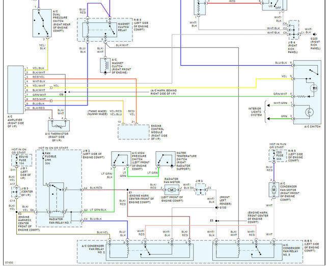

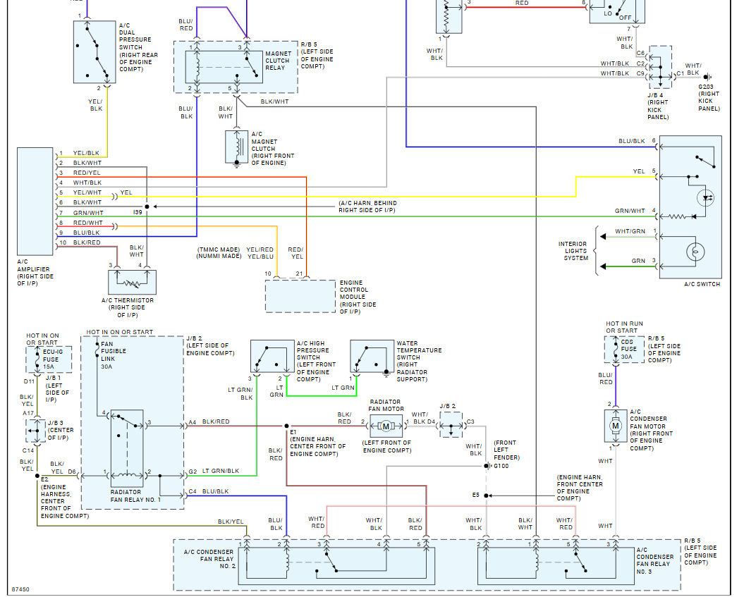

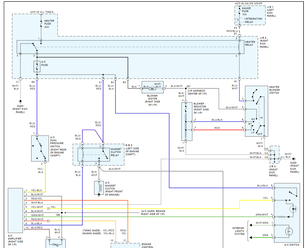

So you say the compressor works with the AC amplifier unplugged? Because the amplifier controls the compressor relay. I am wondering if someone has rewired the car? Please look at the AC system wiring diagrams below to see what I am talking about. Check out the images (below). Let us know what you find.

Yep, it sounds like the wiring got messed with, probably because of the bad amplifier so they tried to bypass it. I would try to put the wiring back to stock using the wiring diagrams above.
