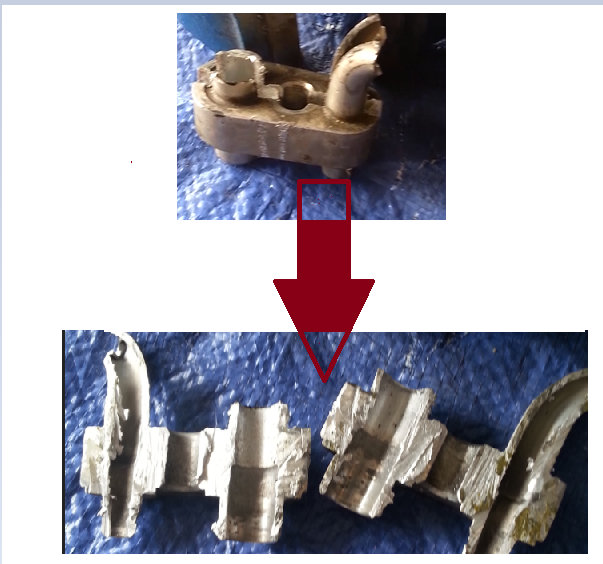

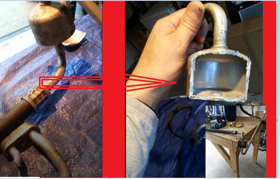

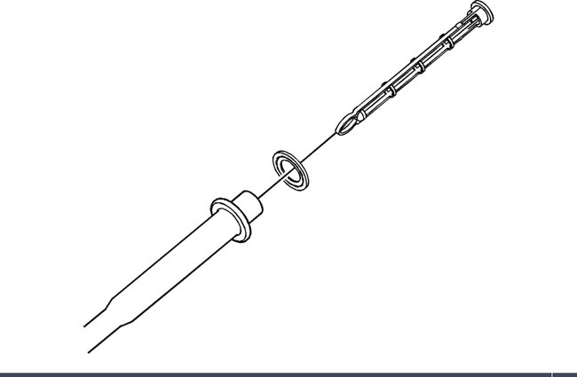

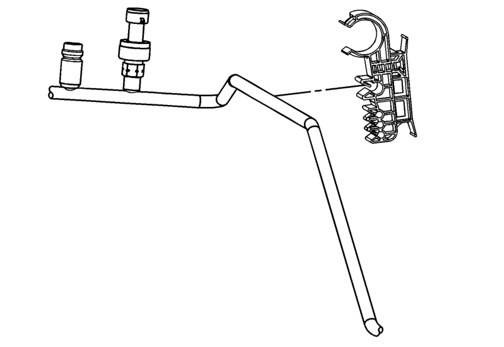

That is not the accumulator at all. That is for the pulses of the pressure when the system is working.
Your system does not have a accumulator as the other systems. It has that filter and that is all. I would not install anything that is not factory at all.
