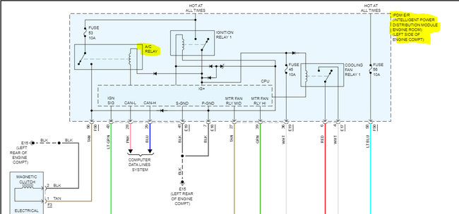

The AC relay is located in the intelligent power distribution module (IPDM). However, for some reason, I feel it is an integral part and isn't a traditional relay that can be replaced because it is part of a printed circuit board.
If you look below, I attached a portion of the wiring schematic. However, when I try to locate that relay in the IPDM, it's not there.
Check if it is and let me know what you find.

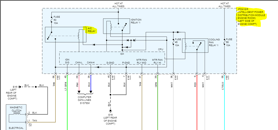

See pic below.
