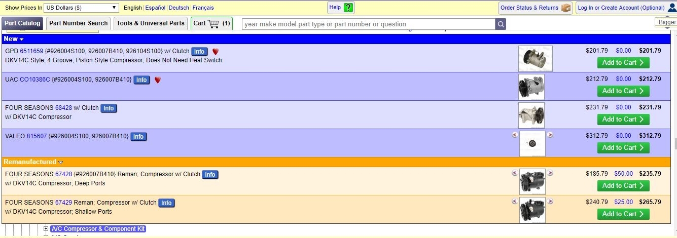

I had fixed an A/C leak on my truck replacing the source of the leak which was the suction hose. I also replaced the drier and expansion valve. Vacuumed the system and no leaks. In recharging the system the static pressures are,low side 94 psi high side 99 psi engine off. Turning on engine with A/C on low side is 11 and high side is 102. The clutch came on but doesn't cycle. Is this a bad compressor?
