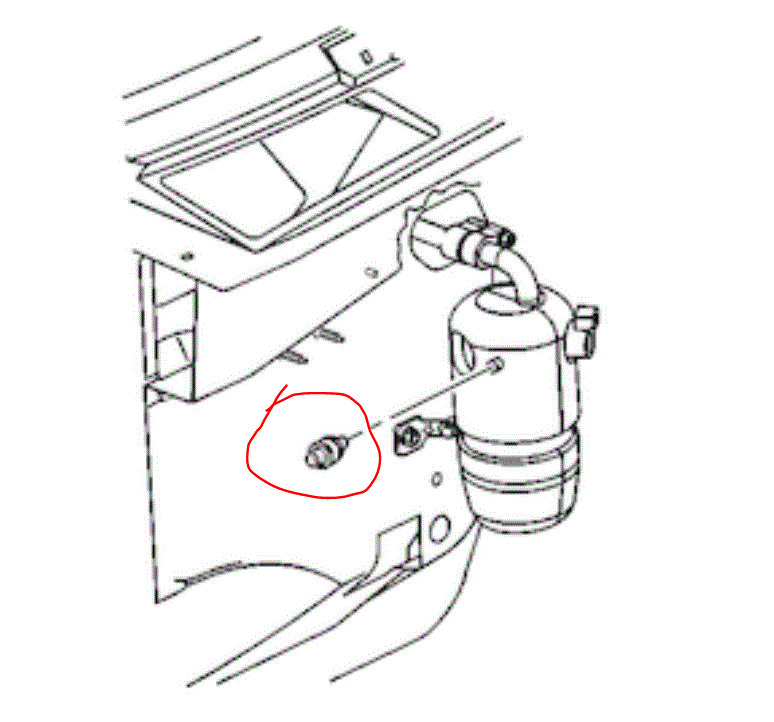

When A/C was working it would run about and hour then freeze up then all of a sudden A/C clutch wont engage. check fuses and relay; they are good but no power to fuse. I was going to test low pressure switch but cant find it to jump it out.
Jul 11, 2020 at 8:57 PM

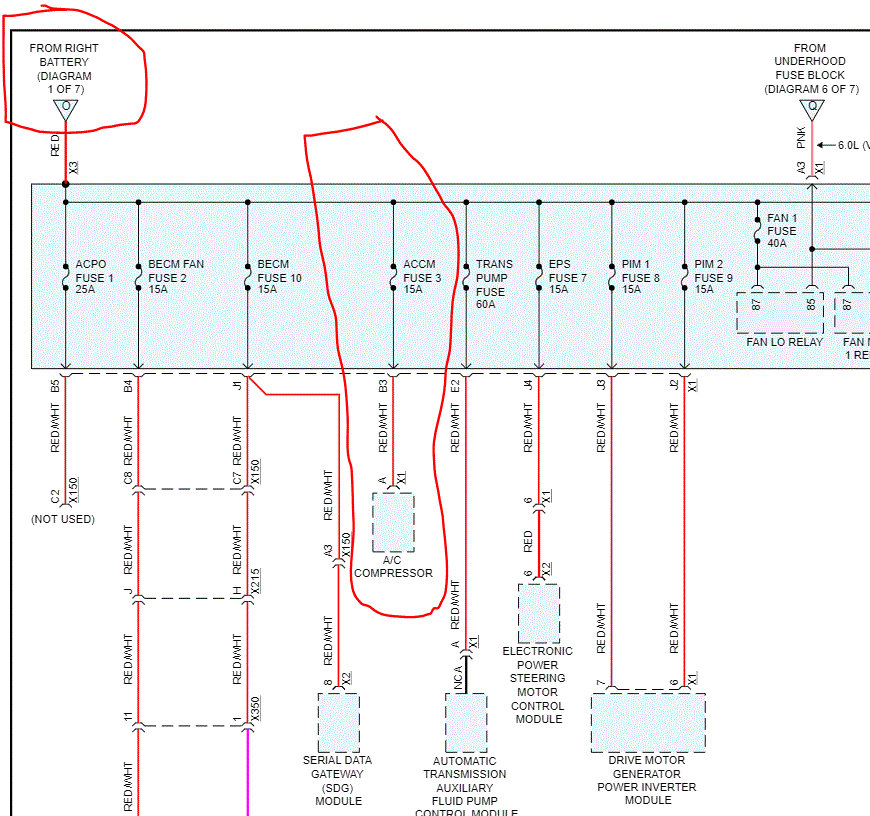

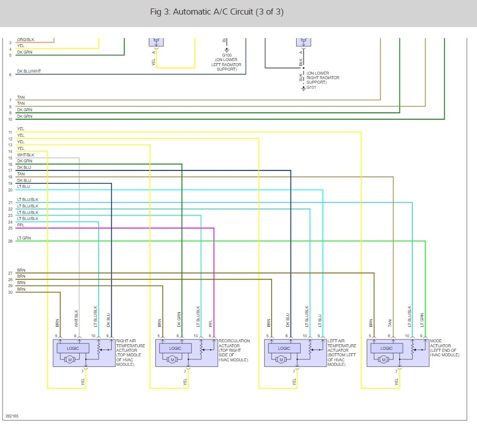

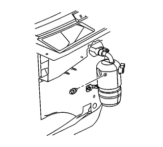

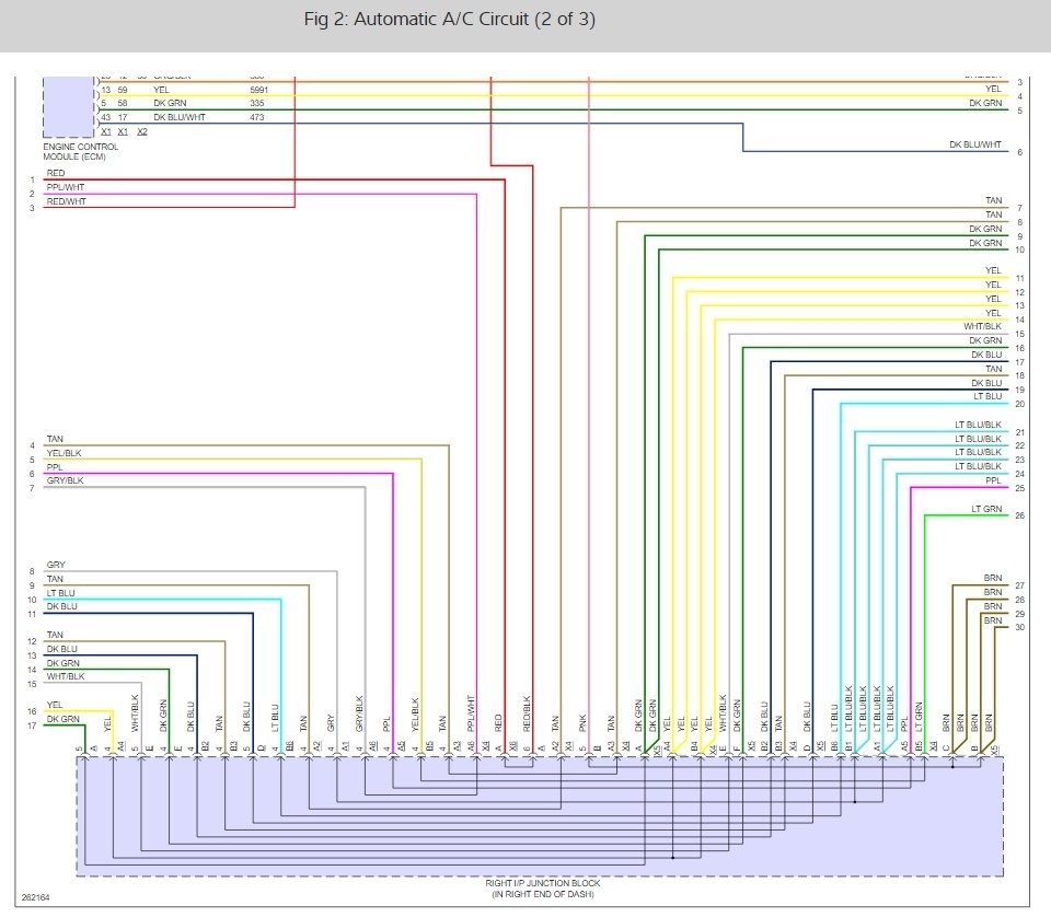

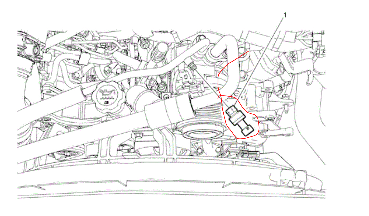

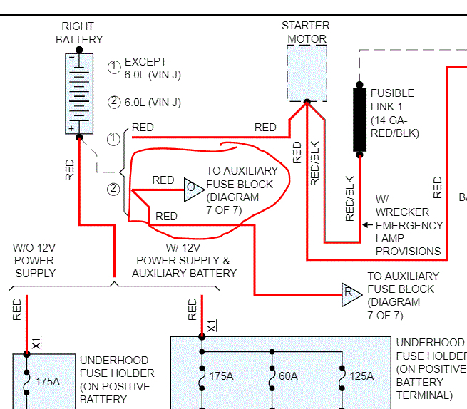

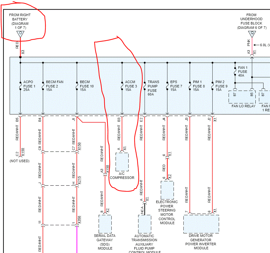

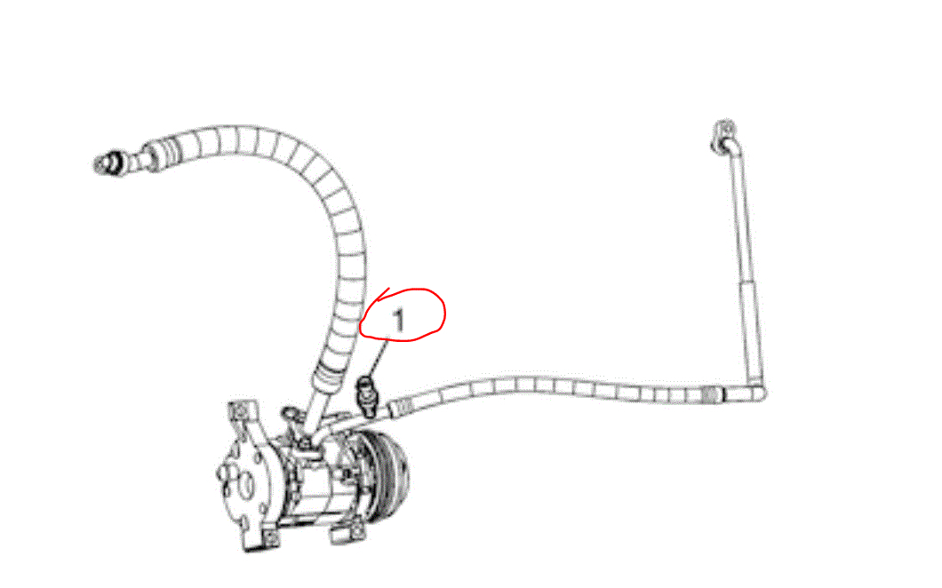

The low pressure switch is on the accumulator. See pic 1. If you look at pic 2, it shows the fuse for the AC compressor. Is there power to any of the fuses near it? I ask because power to that circuit is right from the battery. See pic 3.

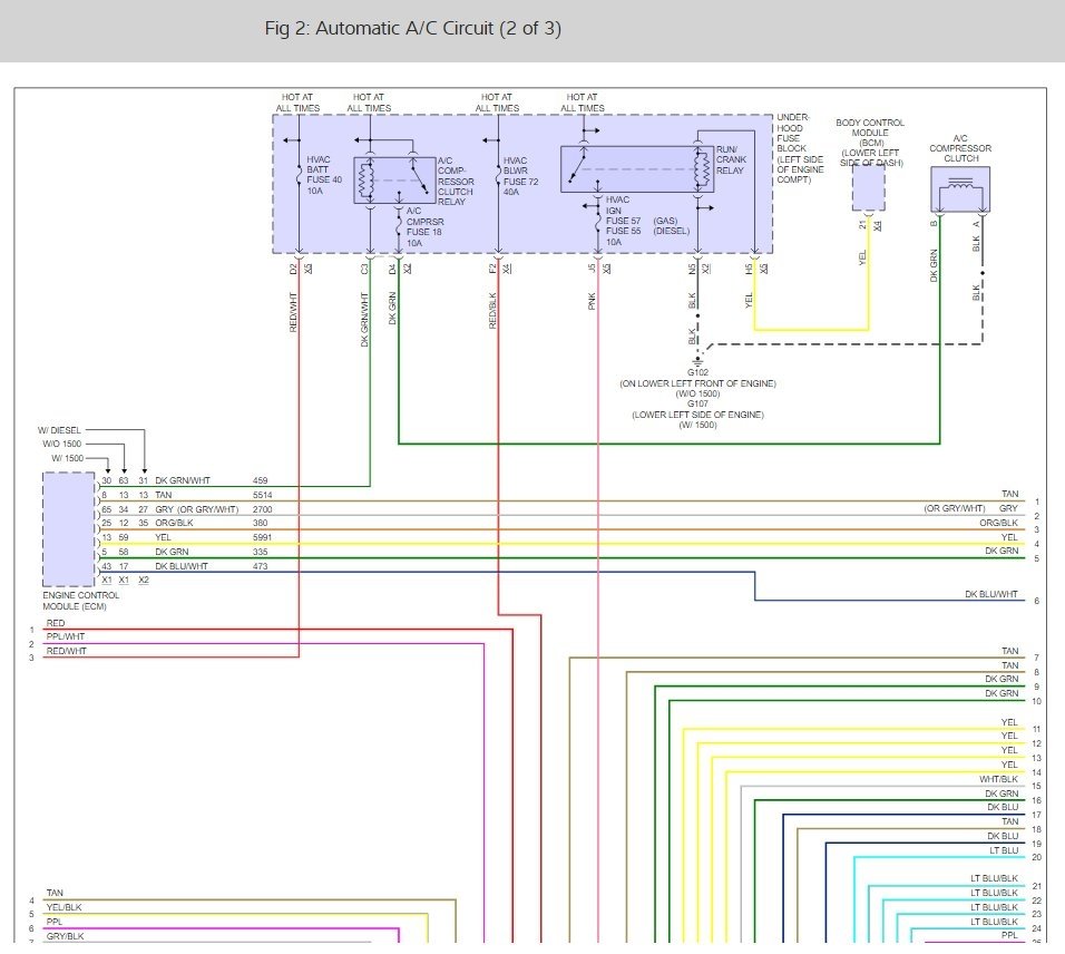

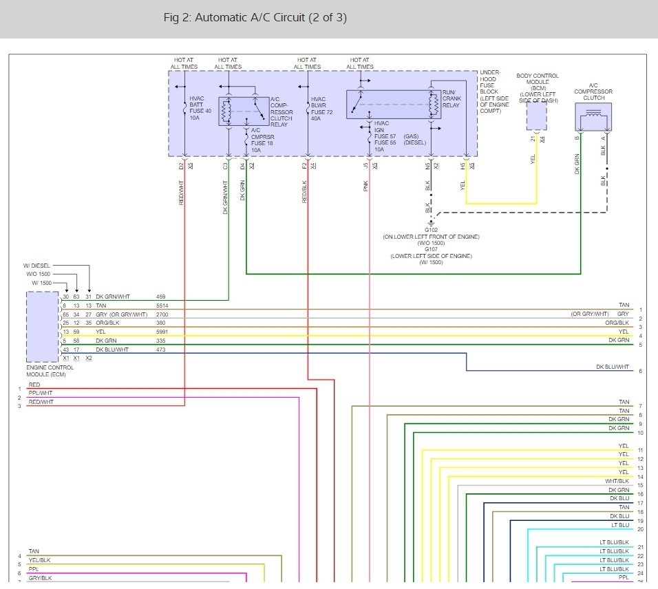

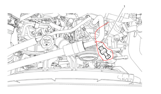

Hi Joe. yes, there is power all around the fuse and on my 2013 the low pressure switch is not on the accumulator. any other ideas where it might be? it's a GMC Sierra 4x4 LST.
Jul 15, 2020 at 6:44 AM

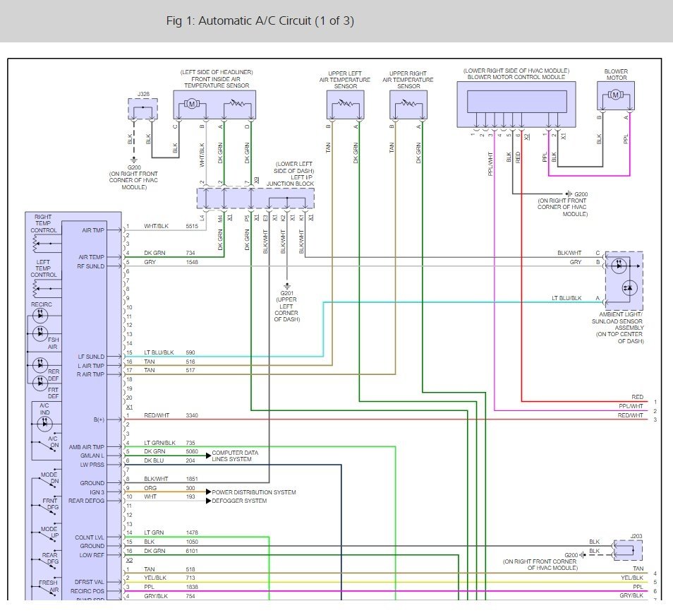

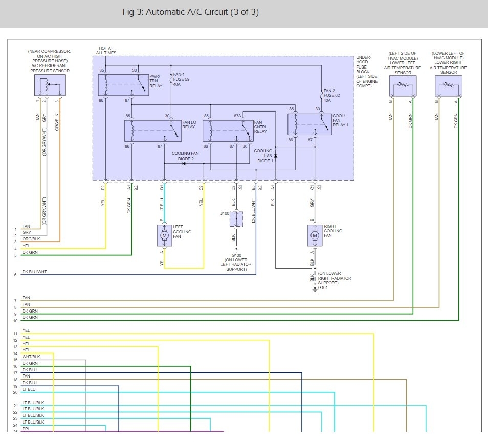

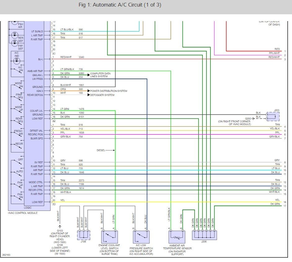

I attached three pics below. This is all there is for this vehicle. If the pressure switch isn't on one of the locations, let me know.
Jul 15, 2020 at 3:22 PM
