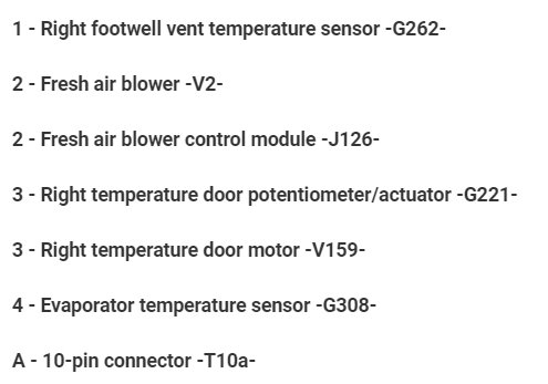

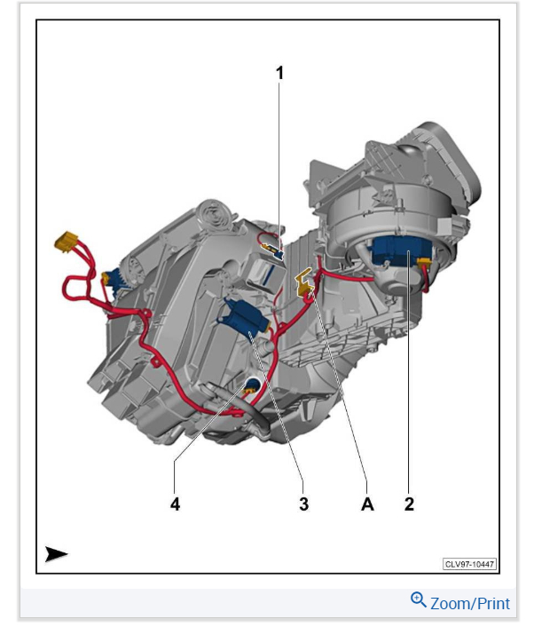

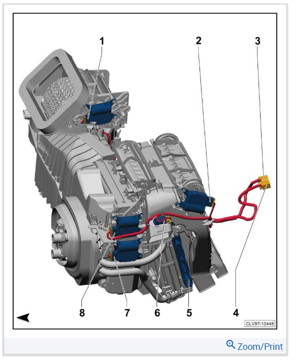

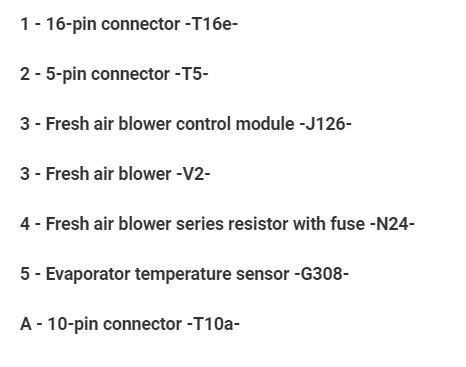

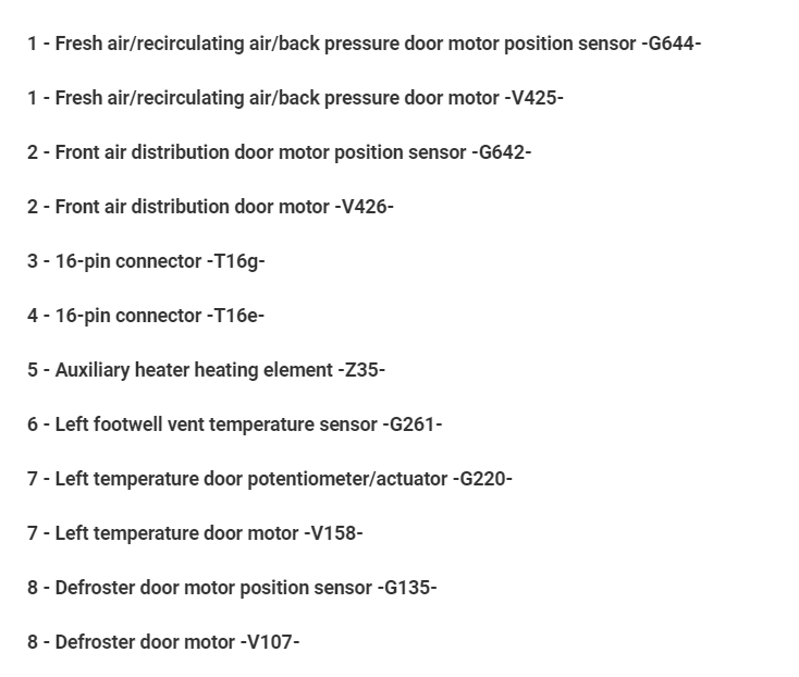

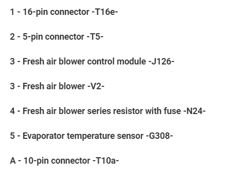

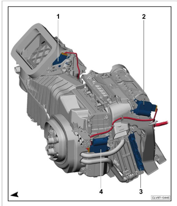

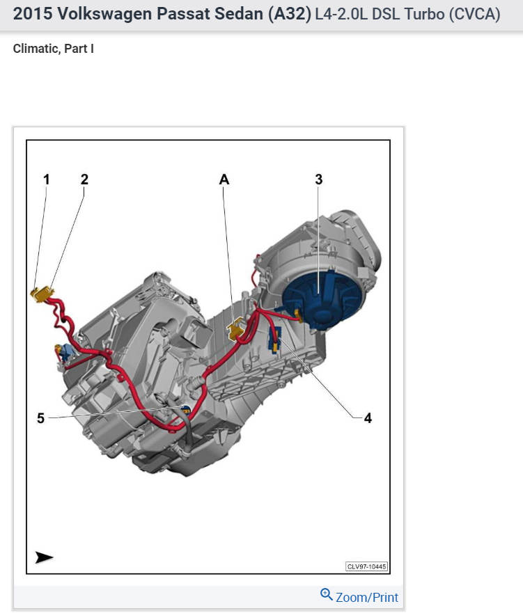

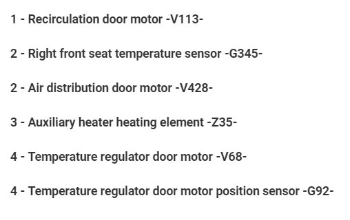

Can you post an diagram of the relay? Trying to find location of that and the thingy that is supposed to turn when going from hot to cool. (Actuator?)
