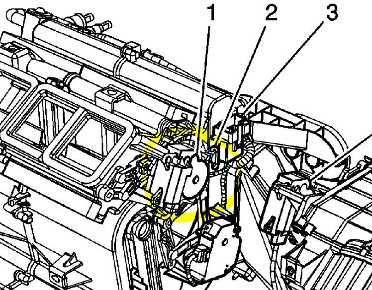

There are several actuators behind the dash.
The mode actuator requires the dash to be removed.
I attached a picture of the actuator. Is this the one you replaced?

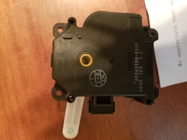

The one right behind the radio is the one I got changed out and the guy that did it said they have another actuator on the driver side. could that be the problem? I'll post a picture of the one I swapped out.
Sep 1, 2019 at 10:46 AM
It sounds like he changed the blend door not the mode door.

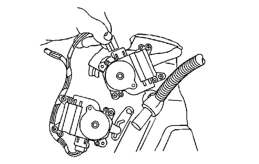

Did you replace the one that I attached with a picture? There are many. The dash has to be removed to gain access to the actuator.
I attached another picture for you. Is the one I circled the one you replaced?
