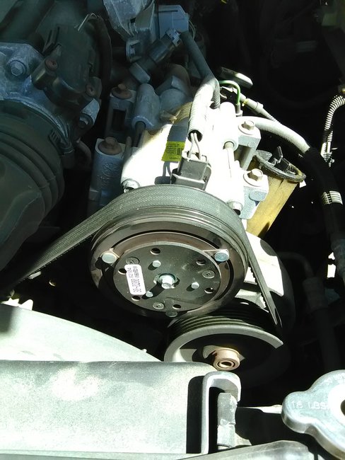

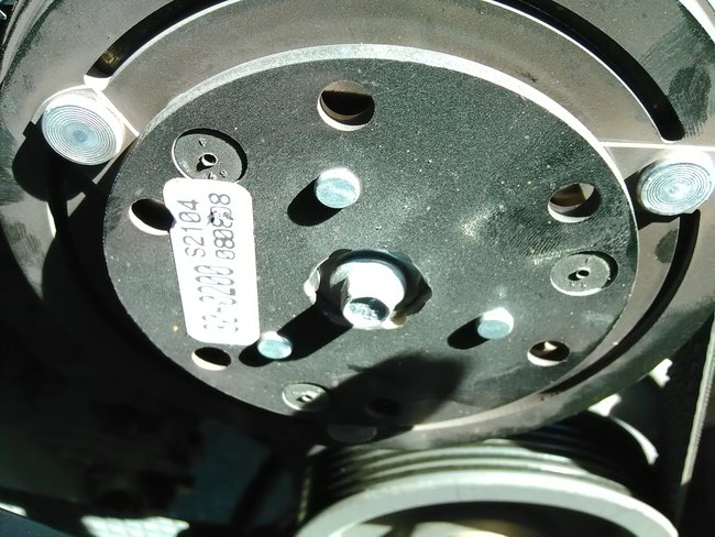

SATURNTECH9
  • 30,869 POSTS
I have seen AC clutches go bad and kill the engine when they engage.But the SC compressor is fine.Can you take s picture of the AC clutch and post it.

WOODWARD2213
  • 5 POSTS
The center spins free.
