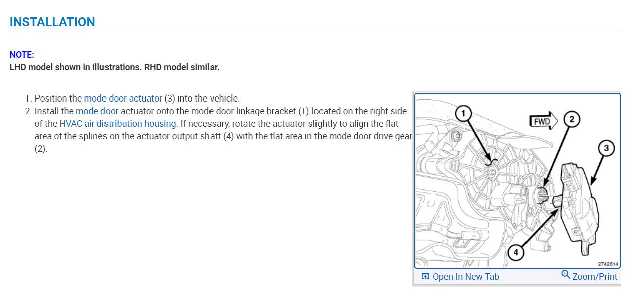

It was mentioned that the front mode door two actuator (defrost) problem and now the A/C clutch sometimes when i shut the A/C off still engaged.
So, i need to know where the location of the front mode door two actuator to remove and change with new one to fix the issue.
The scan code in detail:
B11c5 front mode door two control performance or incorrect operation.
B11C6 front mode door two travel range too small.
Thank you

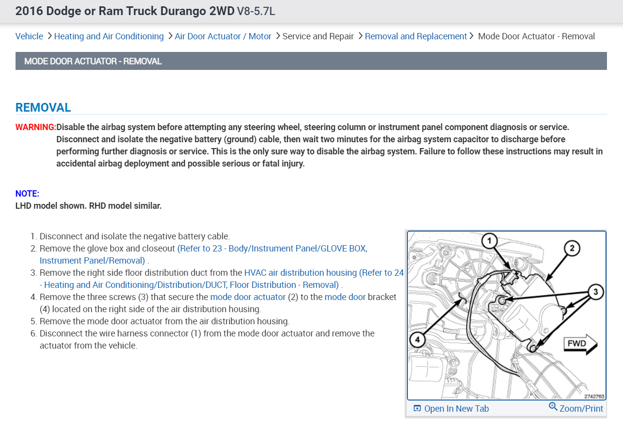

Below are the location and replacement instructions for the mode door actuator. I was wondering if something like a pen got dropped down the vent which happens. Because you have a range code but that could be a bad actuator as well. When the actuator is removed try to move the door pivot by hand to see if it has full range. Check out the diagrams (below). Let us know what happens and please upload pictures or videos of the problem.

but i don't understand where exactly the location of it ?
is it in driver side ? or passenger side ?
because i already open the passenger side under gloves box and the actuator the 2 one the right temp and the re-circulation actuator found there is good after test them by scan tool
so please show me the exact location of the mode door actuator defrost
thank you

Yep. it is on the right side of the HVAC housing. Once removed try to work the HVAC blend door by hand you may have an obstruction causing the issue. You can upload an image to be sure.

but can you please show me how to remove the right side and the location of the mode door actuator because it's in the driver side and need to know where exactly location of mode door actuator is in the driver side.

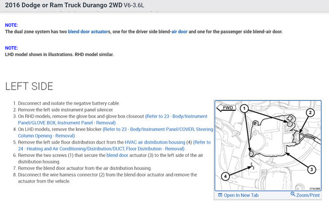

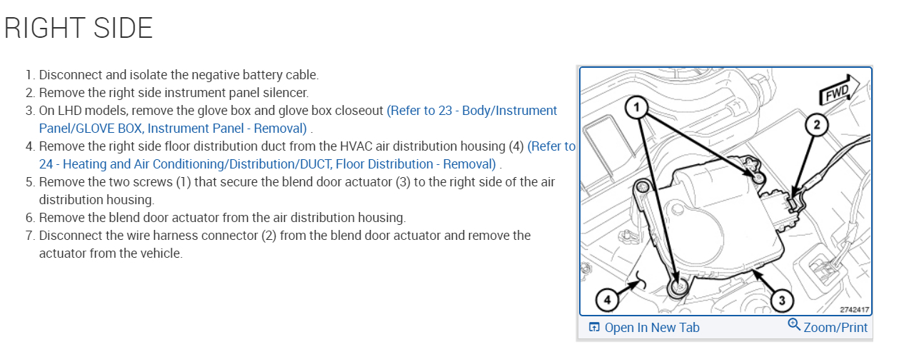

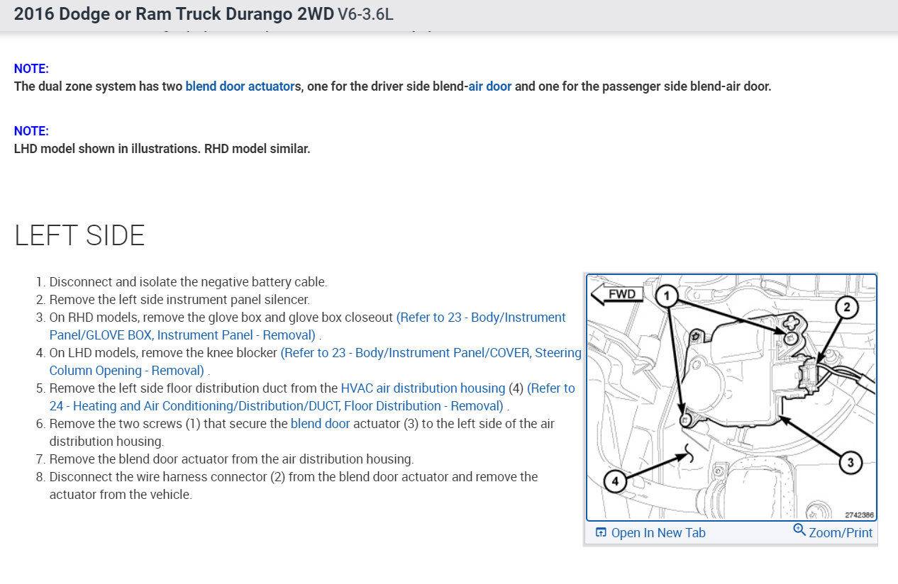

Here are the right and left side blend door actuators in the diagrams below. Let me know what happens.
