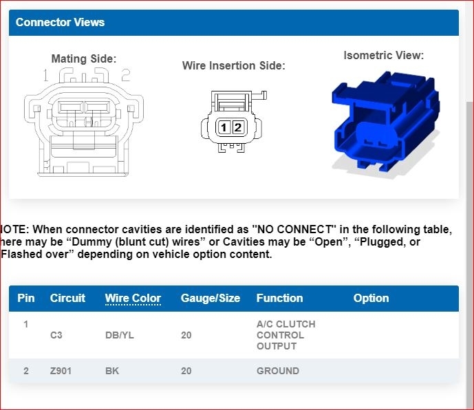

Looking for A/C relay so I can manually engage compressor so I can charge system.

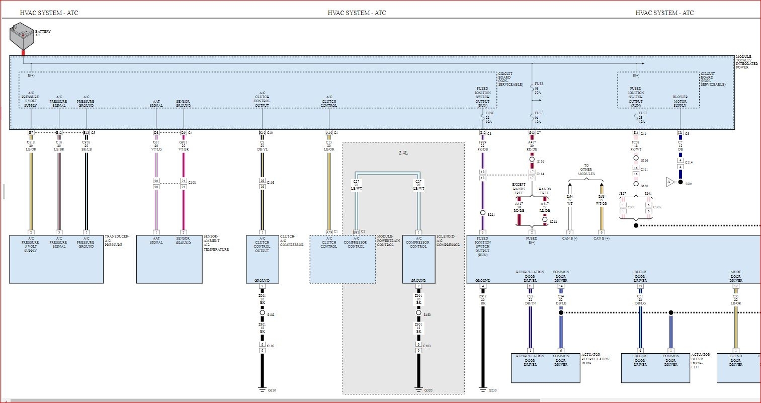

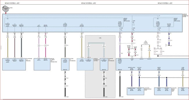

This vehicle has what is called a TIPM or totally integrated power module. There are no relays for the clutch. It is contained within the module on a non serviceable circuit board.
You would have to jump power directly to the compressor. However, if you turn it on and start filling the system, the compressor should kick on once you get a minimal amount of pressure then the compressor will short cycle and pull more in and eventually run as normal.
