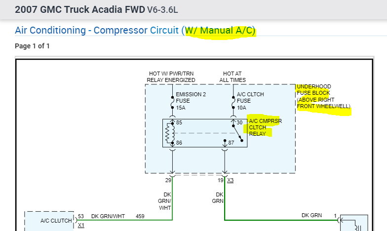

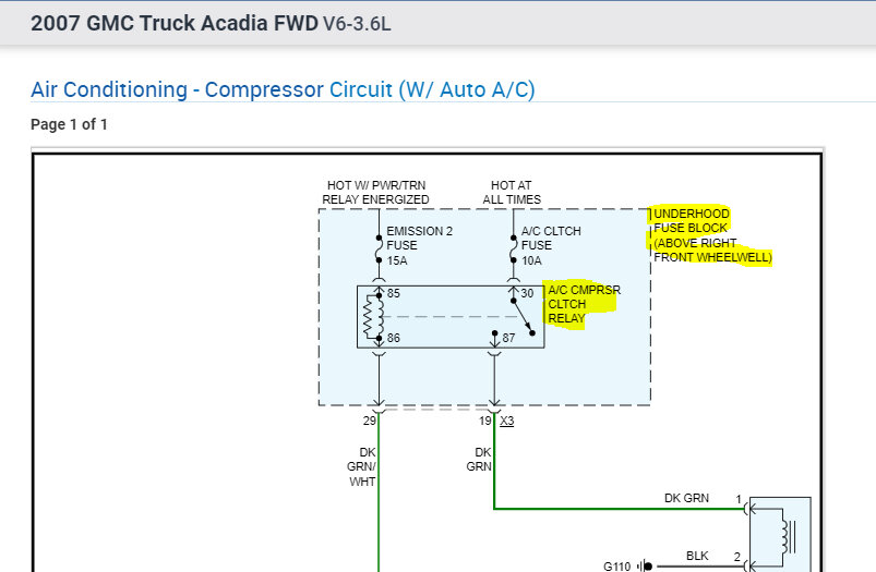

When this happens, I need you to check to see if the compressor clutch is getting power. If it is, suspect a problem with the clutch coil. If there is no power, then we need to check the clutch relay in the under-hood fuse box.
I'm not sure if you have automatic climate control or manual control, but I looked at both schematics and the relay remain the same. See pics 1 and 2 below.

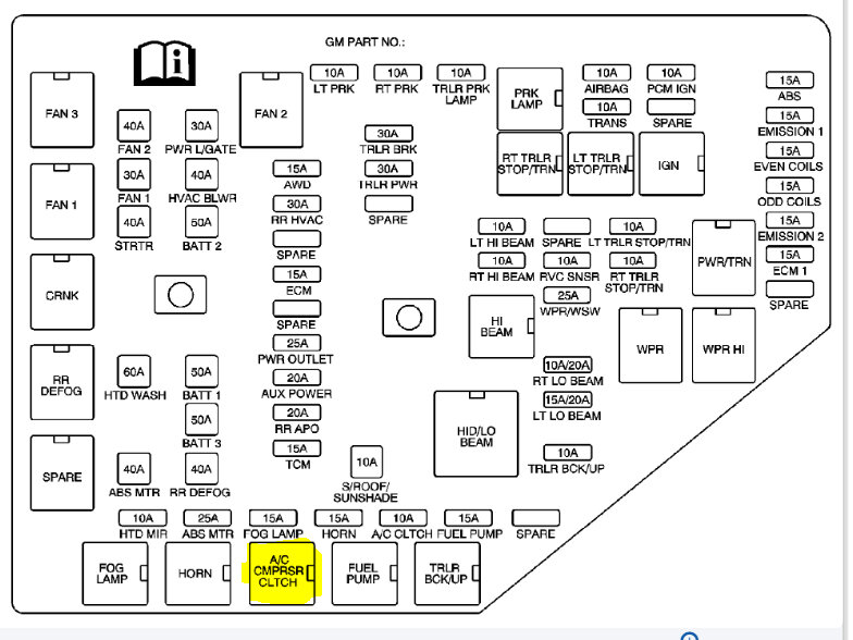

As far as the relay, if there is a different one in the box having the same part number, switch them and see if that changes anything. Also, if possible, we need to check AC high and low pressures. If after it runs the pressure is getting too high, it won't restart. Actually, when it stops running it may not be a cycle but rather the high-pressure switch turning it off.
See pics below. Pic 3 shows the clutch relay I mentioned.
