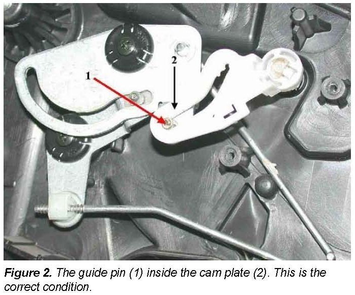

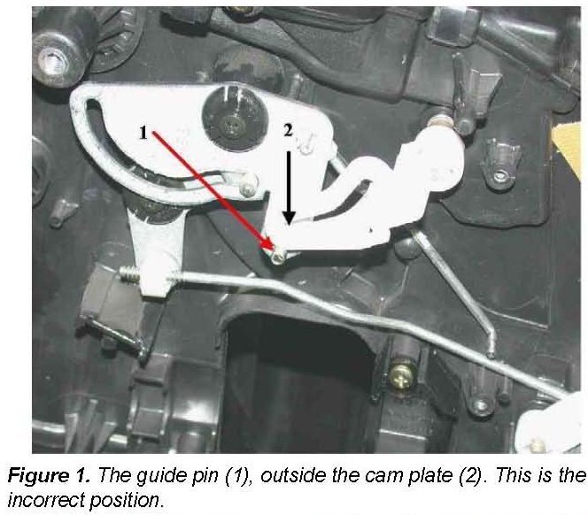

There is a TSB that might cover your problem. It relates to a guide pin on the actuator coming apart. To check this you remove the panel above the drivers side foot well and you can see the actuator. The pictures show the bad and good position for that pin.
