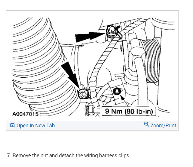

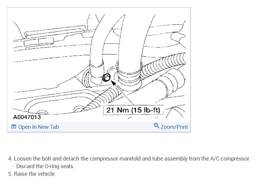

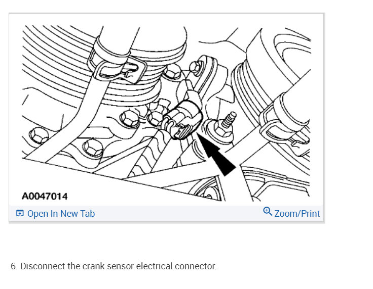

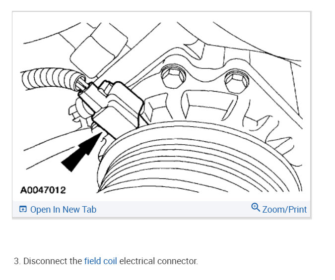

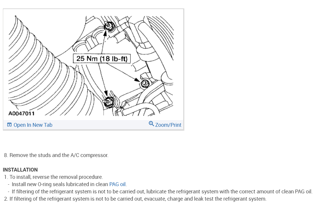

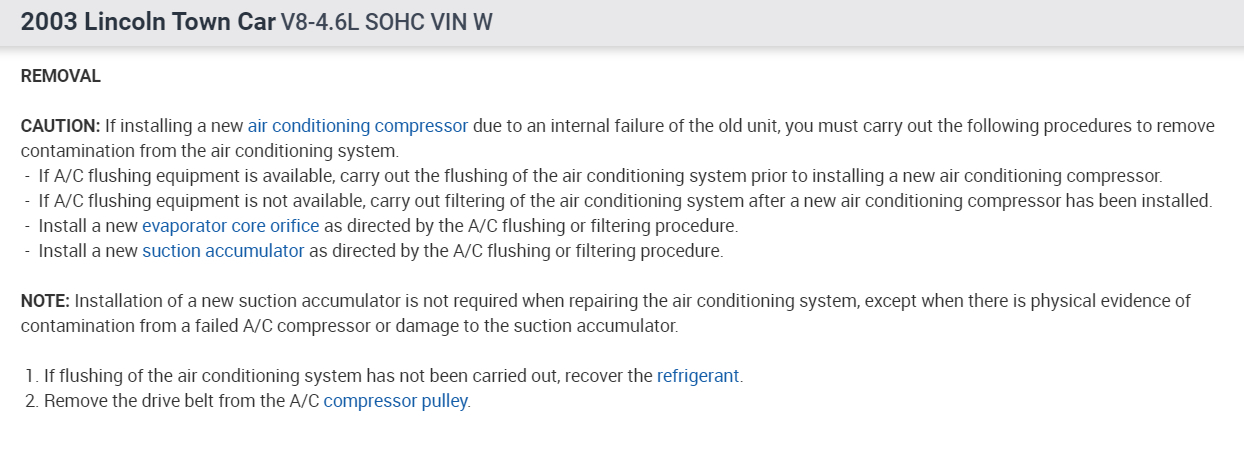

Yes, this happens when the A/C compressor is locked up which is common. I would grasp the front of the compressor to see if you can turn it (engine off). If you cannot turn the compressor this guide can help you change the compressor out with instructions in the diagrams below to show you how on your car.
