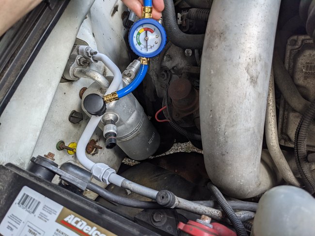

-I tested the pressure with the A/C on (noticing the clutch was not engaged at all) and it only read about 10.
-I added a small amount of charge and the clutch started to engage in short bursts, which did not result in cool air.
-I unclipped the sensor and jumped it, resulting in continuous running of the clutch and ice cold air blowing into the cab, but very low PSI reading.

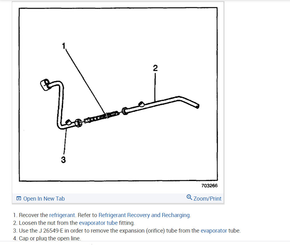

-But I noticed the pipe into firewall was pretty quickly icing up which seems bad, the ice stops mid pipe, so maybe clog?
-NOW: 1-System running as is, no or intermittent clutch engagement = Very high (red) pressure reading, hot air. 2- Running with jumped sensor = Very low pressure reading ≤10 blowing cold

-Is this line clogged, if so how do you fix that?
