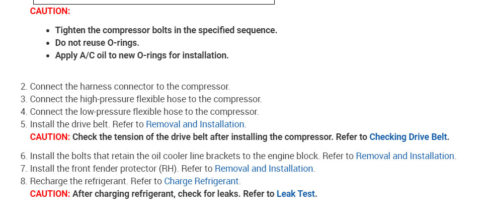

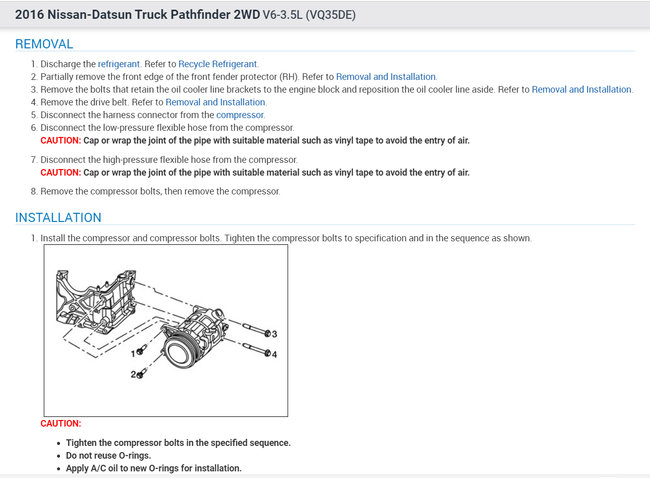

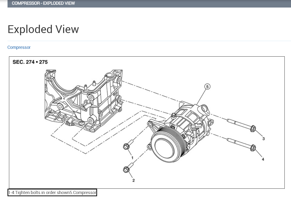

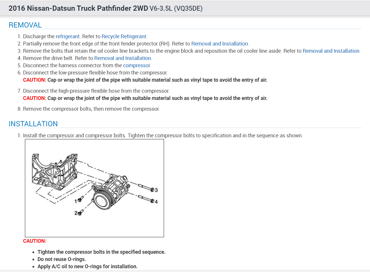

It sounds like the A/C compressor has let go but I noticed it is on the driver's side of the engine. Do you hear the noise will the A/C is off? If not, the compressor is probably the culprit.
This generic guide and video will help you see what you are in for when doing the job which you will need to run to the auto parts store for to rent a gauge set and vacuum pump. I have included the location and instructions for your car in the images below.
