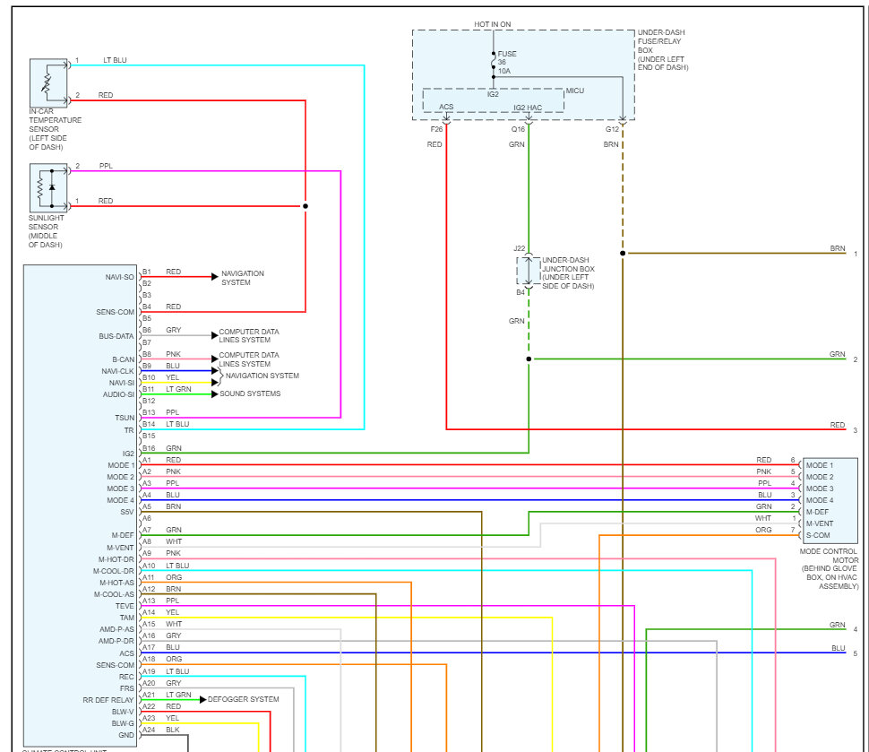

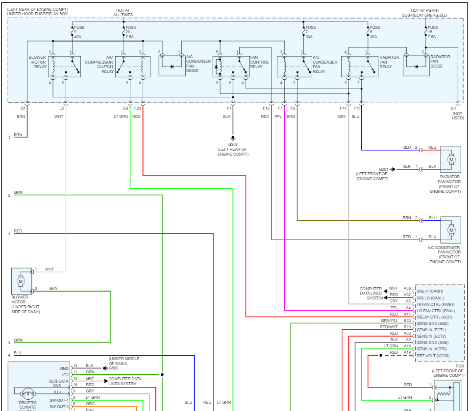

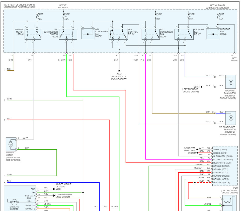

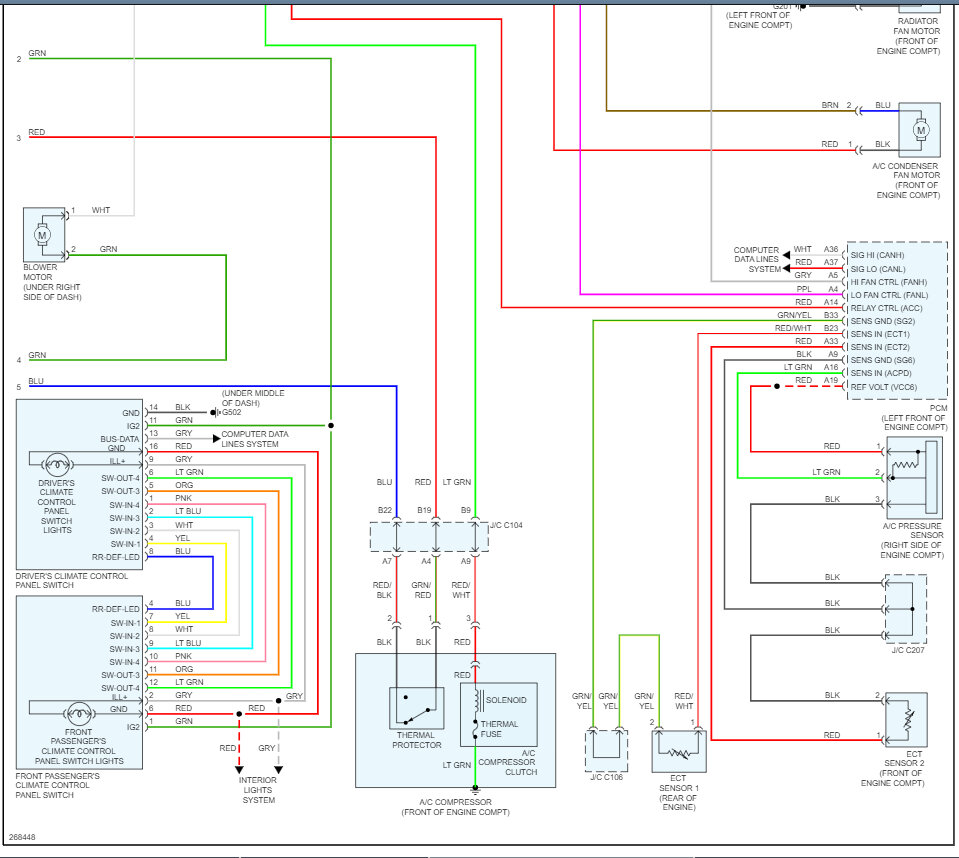

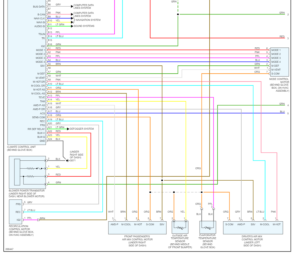

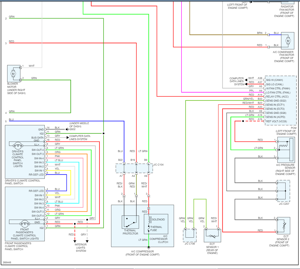

Yep, that sounds correct. I wonder what the high side reading is when it cuts out? Please check out this guide can well, and I have included the A/C system wiring diagrams so you can see how the system works.
https://youtu.be/4EqdrBVb0sY
Check out the images (below). Please let us know how it goes.
Jul 10, 2023 at 9:55 AM
HARDY PANCHAL
  • 5 POSTS
Display shows me pressing the A/C button on and off, but the ECU is not reporting to the Snap-On versus that the A/C switch is commanded on or off. Can anyone look at the diagram and tell what could be faulty here? I revised all the pressures and vacuumed the system and refilled it with the right charge, new relays and new pressure switch.

I would check the IG2 power inputs (green wire) on both the drivers and passengers side control switches.
Please check with the key on. Let me know what you find.

Also, I'd like to note that. This car's climate control inputs go through a canbus module. It's getting power since dash says A/C is on. And the compressor even turns on and shuts off.
Jul 11, 2023 at 3:41 PM
You might have a bad MICU, we should perform a CAN scan, you can get a CAN scanner (Controller Area Network) which will work on most cars from Amazon.
