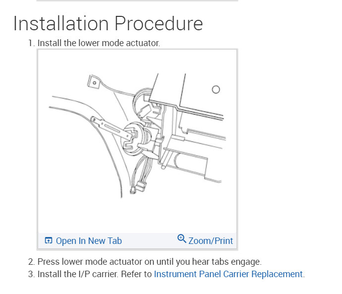

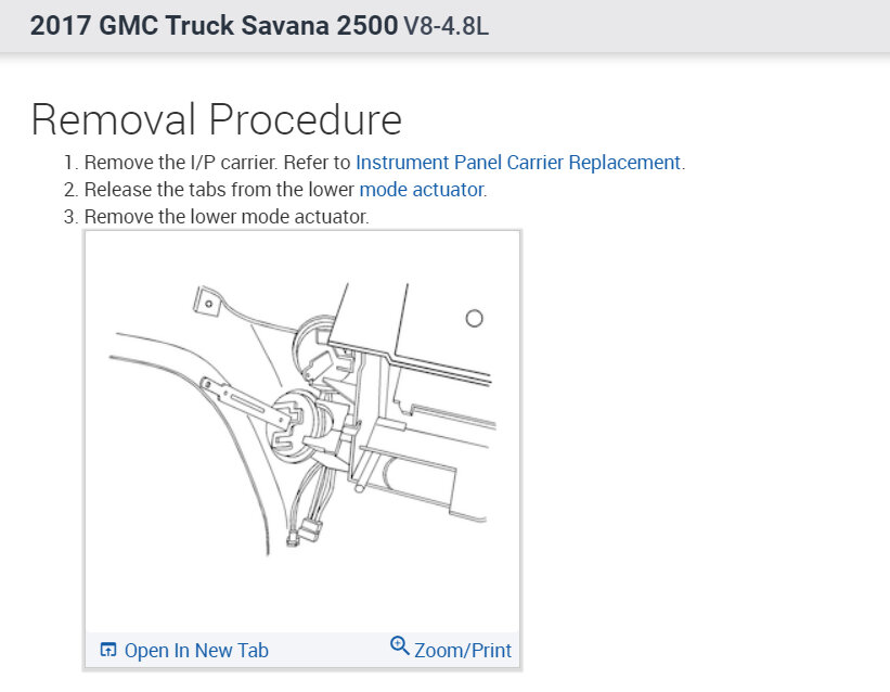

Yes, this happens when the mode actuator goes out or you have lost vacuum to the HVAC system which is a small vacuum tube under the hood. here is the location so you can change it out:
This guide can help as well:
https://www.2carpros.com/articles/air-vents-stay-in-the-defrost-position
Check out the images (below). Let us know what happens and please upload pictures or videos of the problem so we can see what's going on.
