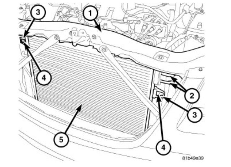

If you look below, I attached a pic showing the A/C condenser. Make sure it is clean and not clogged with debris. It looks like the coolant radiator, but it is actually mounted to the front of the radiator. If it looks dirty, take a garden hose and do your best to clean it.
See pic below.
