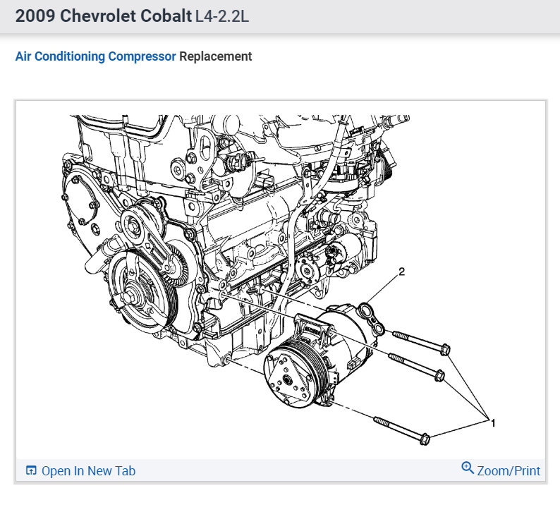

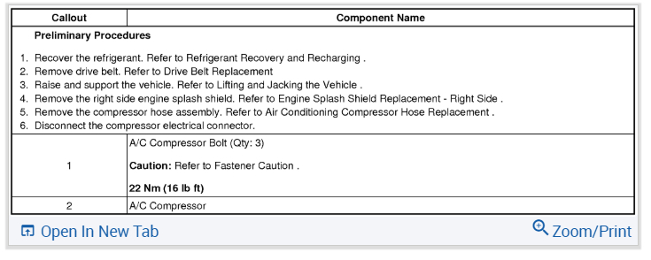

It looks like the compressor is going out because the pressures should be higher/lower. Here is a guide to help you change it out with diagrams below to show you how on your car:
https://www.2carpros.com/articles/replace-air-conditioner-compressor
and
Check out the diagrams (below). Please let us know if you need anything else to get the problem fixed.
