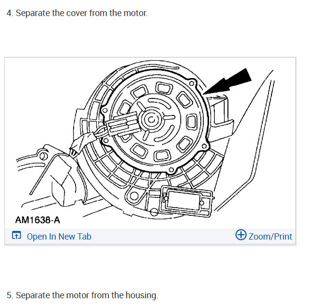

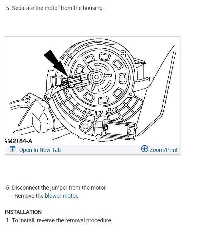

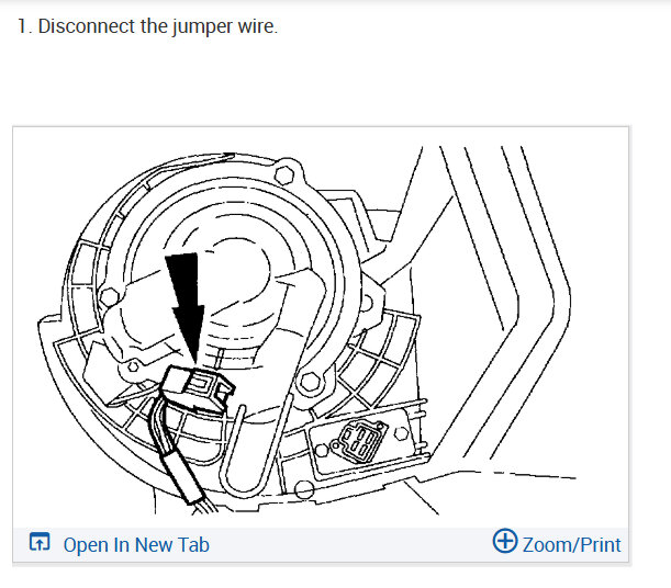

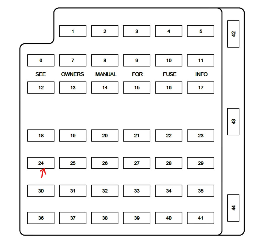

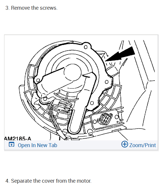

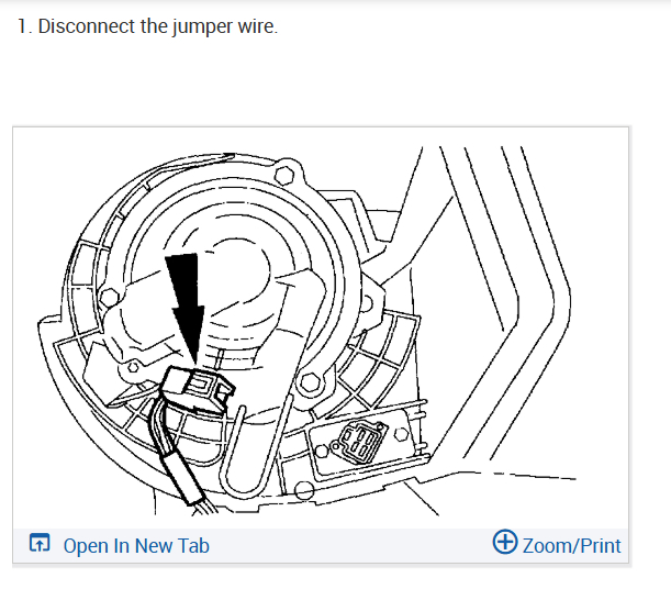

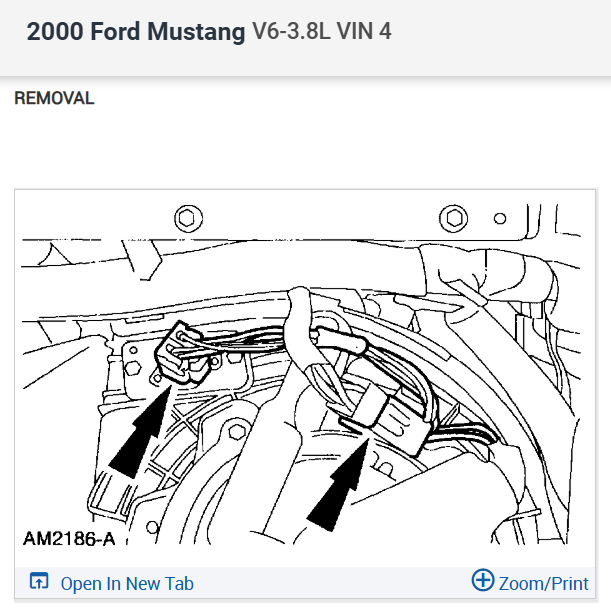

Okay, most of the time it will be the lower motor but as should check the fuse #24 which is under the fuse panel.
Here is a guide that can help and the fuse location in the diagrams below:
Check out the images (below). Let us know how it goes.

The fuse is good.

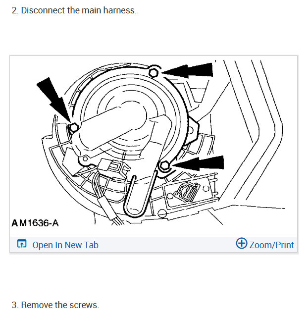

Okay good, let's use this guide to check for power and ground at the blower motor, chances are the blower motor has gone bad but this will confirm the problem.
https://www.2carpros.com/articles/how-to-test-an-automotive-hvac-system-blower-fan-motor-a-detailed

Up, chances re the blower motor is bad, I would use the guide above to confirm the issue and then replace the blower motor.
