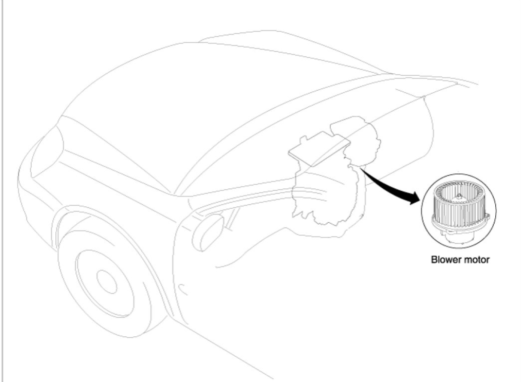

The blower motor is located down in the passenger side footwell, you should hear it running down in that area. If not, then there's an issue with the motor.

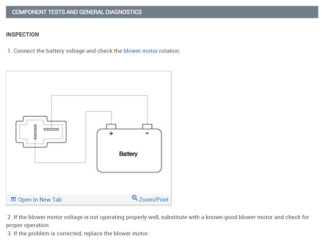

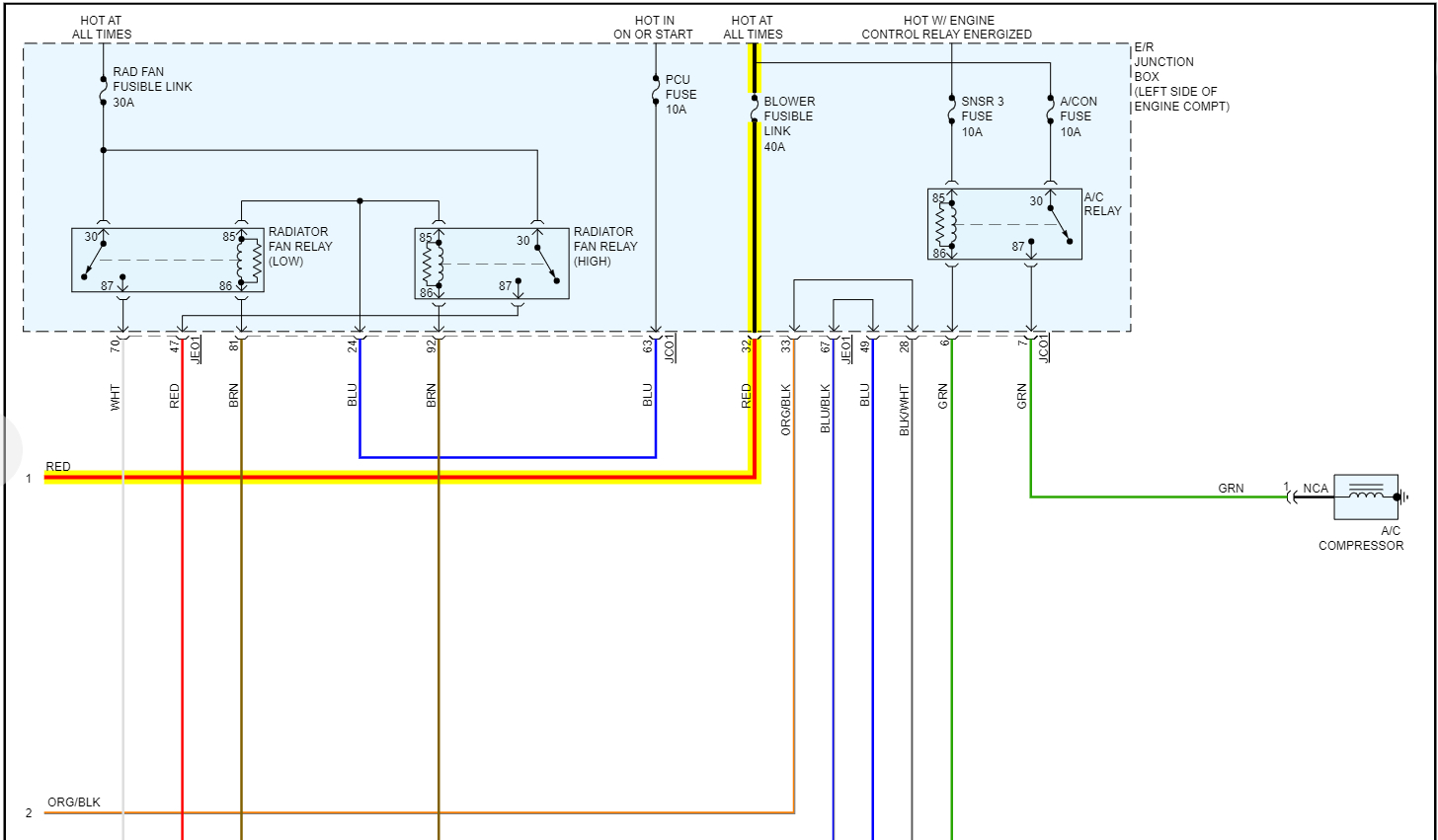

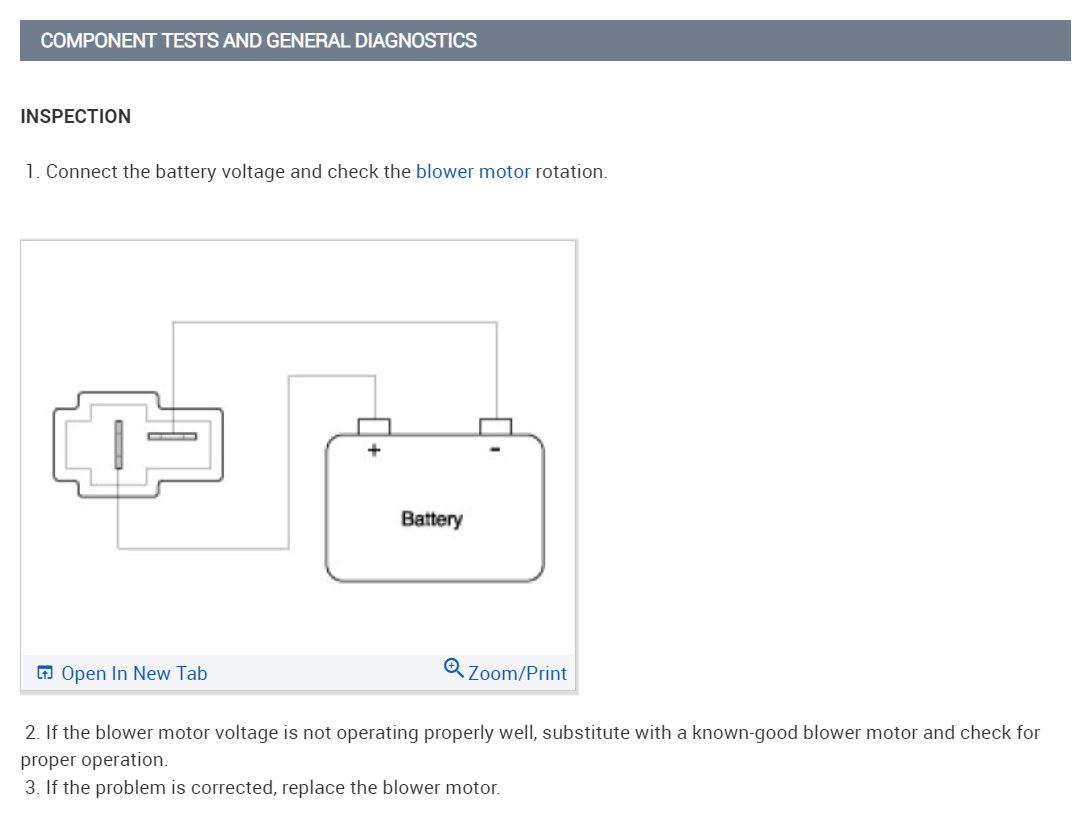

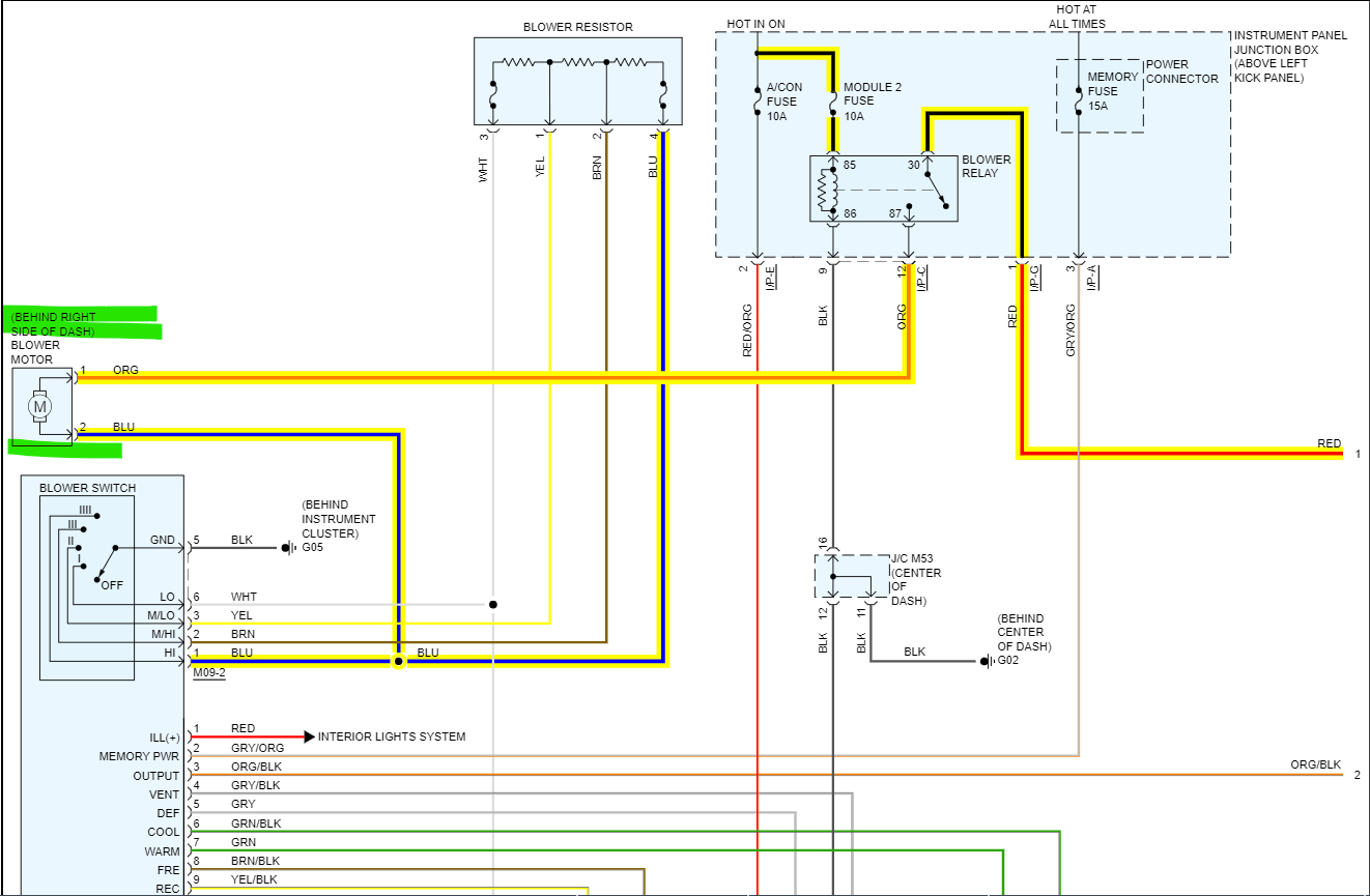

The diagrams below are of the Manual A/C system, just to give you an idea of the blower motor circuits and the fuses that power it
The 4th diagram is the blower motor connector, it can be tested with a test light or multimeter, just unplug the motor and check for power across the positive and negative pins of the connector with the air turned on. At high speed it should read around 12 volts. Or light a test light brightly.
