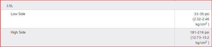

BOUSHEHRI
Thank you Roy. What would be the high and low side pressure setting?
Thanks
Jul 8, 2018 at 6:36 AM
DANNY L
  • 5,648 POSTS
Hi, I am Danny.
I found these specifications for you (picture attached). Hope this helps and let us know if you have any questions! Thanks for using 2Carpros.com. Danny-
