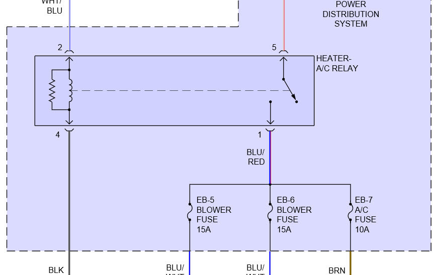

when I push the button the A/C on it does not come on. the light does not light up when you push it to indicate it is working. it was working fine yesterday.

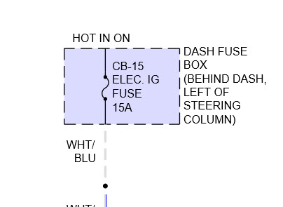

check fuses and relay first. See pictures. relay and three fuses are under hood other is in car. otherwise it must be scanned for codes by a mechanic.
