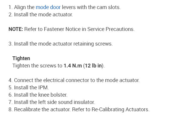

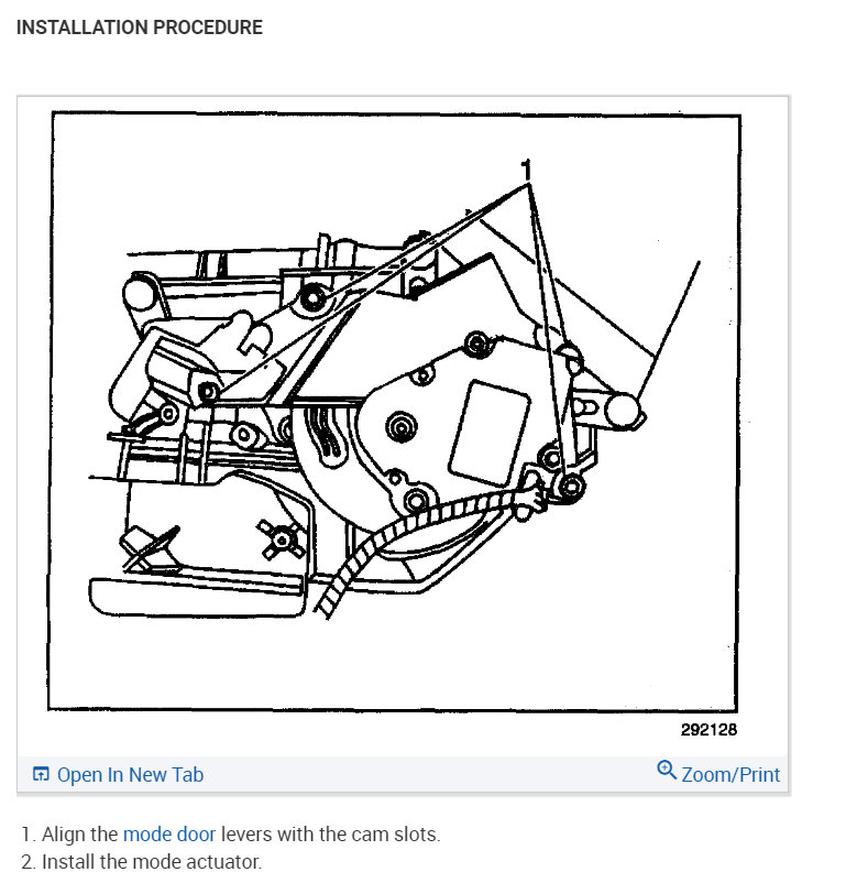

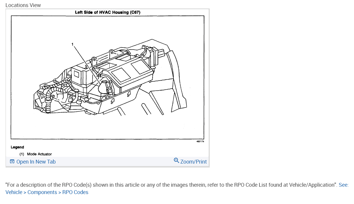

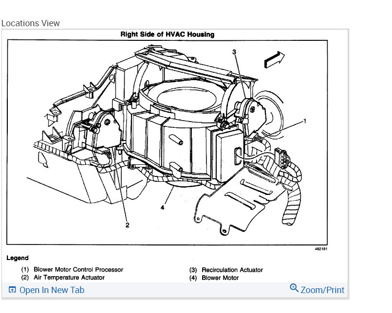

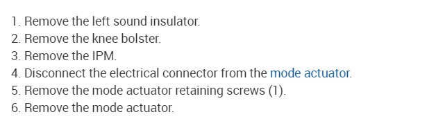

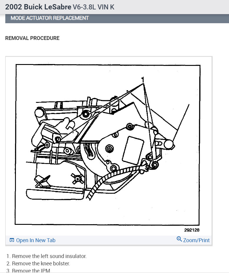

This happens when the mode actuator stops working. here is the location of the actuator and how to replace it in the diagrams below. Check out the diagrams (below). Please let us know what happens.
